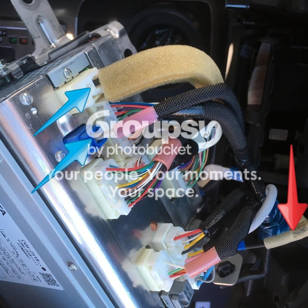

I have a 2012 trail with the non jbl with nav stereo unit. I need help finding which wires is the factory back up camera and antenna wire. I looked all over and found kingpins thread but his photos aren't working. Here is a picture I took of the back of the unit. I'm installing an aftermarket head unit...
Also which one is the reverse sensing wire?

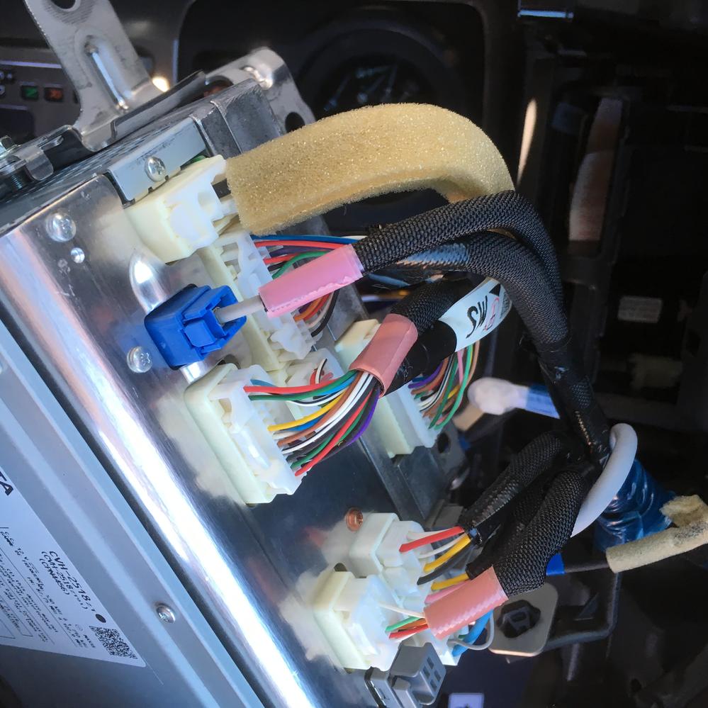

Hello folks.

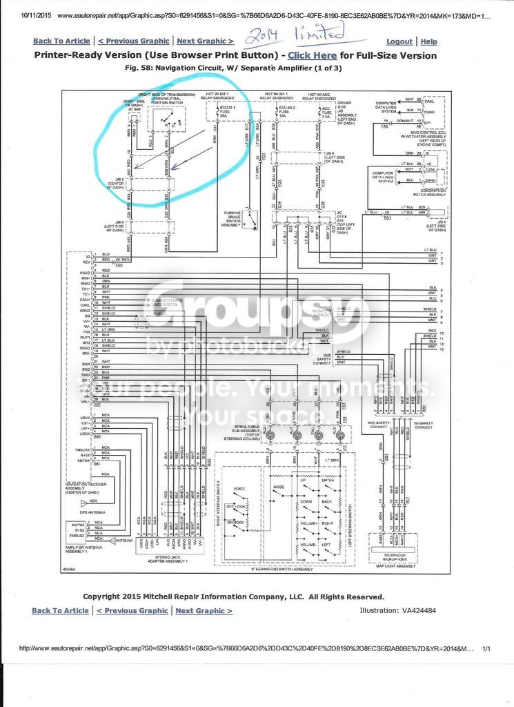

Hi ahproh,
In the photo below, The GPS antenna is marked by the RED arrow. The Back-up camera uses a Shielded cable and is likely one of the two cables I have highlighted with BLUE arrows; the harness is compiled of four wires: RED, BLK, WHT, and Shield (color unknown). You'll need to pull the two connectors from their receiving portals to identify the wire colors beneath the shield to reveal it's usage.
The REV lights trigger wire is RED and lands at the number 2 terminal on the HU's rear panel: "See the blue circle and arrows upper left-hand corner on the diagram below". It's almost impossible to ID these wires using a photograph so you'll have to figure it out based on the diagram and the actual navi-unit, Best!

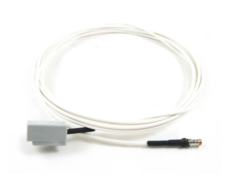

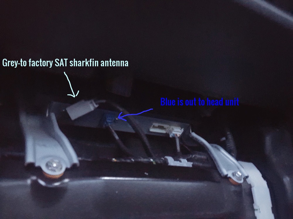

Info for using SFA12F cable on JBL/NAV 4runner with aftermarket head unit
I wanted to add this for others that want to use the factory Sat. antenna with an aftermarket head unit. I couldn't find this anywhere when i searched.
SFA12F is the cable used . see pic
Female end of SFA12F attaches to the 300v1 or whatever you choose to use.
End with plastic attaches to the cable (one you disconnect from the box under pass. seat) that runs to the antenna in the shark fin.

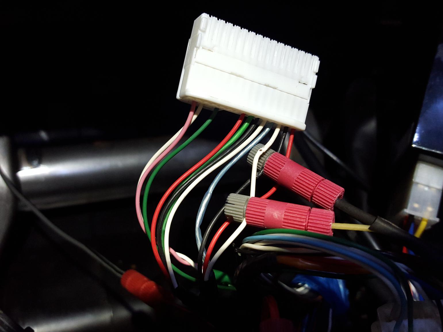

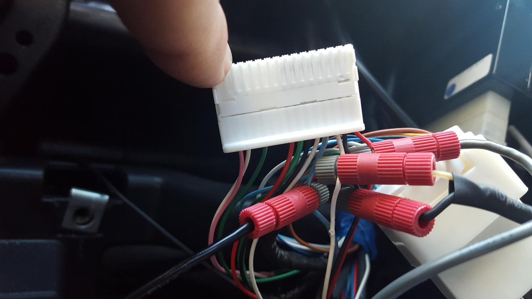

For those who want to use the OEM camera JBL/NAV. 2010-2013
I couldn't find any info on doing this mod with a factory JBL/NAV head unit 2010-2013?
I'm not 100% if this will work on the newer years. but if your plug matches up you are good to go.
I didn't convert to 6v and the camera works great. But if you want to I found this on Amazon.
Amazon.com: SMAKN Dc/dc Converter 12v Step Down to 6V/3A Power Supply Module: Electronics
This is seriously an easy thing if you know the wiring.
I used posi-tap connectors.
Pin 21 blue camera ground
Pin 22 white video
Pin 23 Black video shield
Pin 24 Red camera power
First pic is the camera feed to RCA.
Second pic I attached the power and ground.
Thank you. I ended up using this on my install and it works great!
Pin 22 white video
Did you connect the Red camera power wire to a constant 12V source or a switched source? Any negative effects from running it 12V for a few months now?
