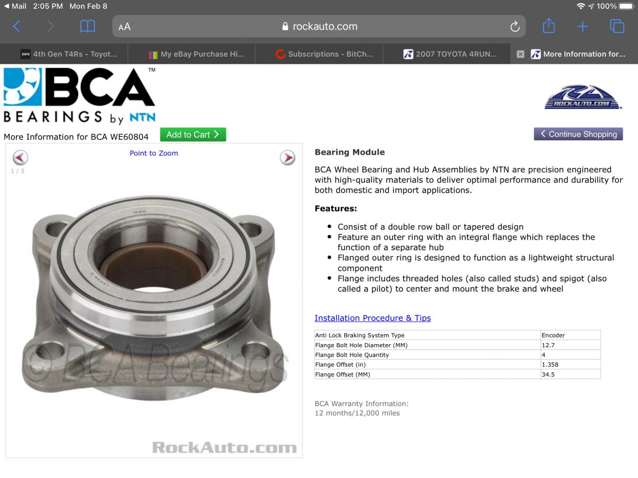

I was checking rockauto and noticed they have a brand Im not familiar with BCA but made in IL USA. Cost $49 and uses a Japanese NSK bearing.
Has anyone used these before.
I noticed the Rockauto picture for Centric also showed the NSK bearing. NSK is supposed to be good so I hear.
