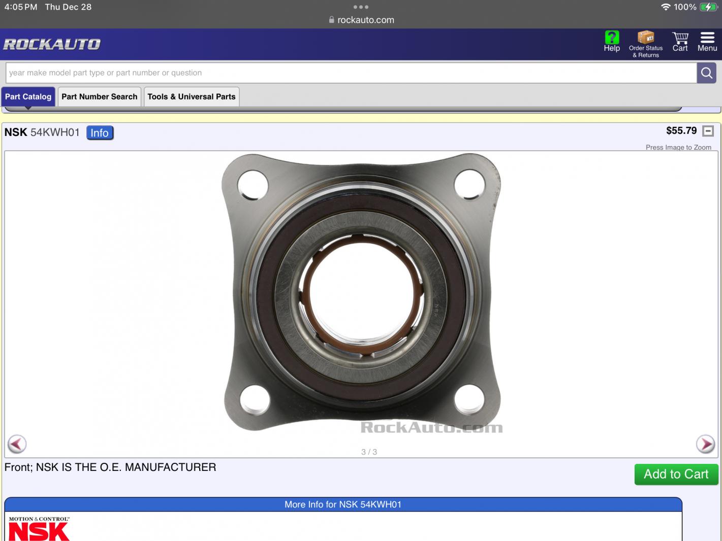

Honestly, I think the SKF unit uses a chinese bearing. Check for the ones stamped made in Japan like NSK. Much better quality.
Last I looked I couldn't find any hub assemblies on RA that had something stamped on the bearing so I assume all Chinese now. They don't list the Centric ones I mentioned earlier in this thread and the Beck/Arnley no longer is stamped per the pictures. :(

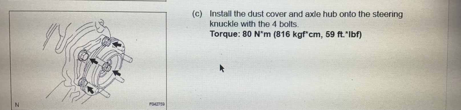

Buy the bearing and have a local shop press in your original axle stub. And it will be cheaper too. $55 for a bearing and $20 press work. Be sure they insert the bolts before pressing.
I purchased the SKF hub a year and a half ago and was able to confirm with an SKF engineer I work with that it is an SKF bearing assembly.
I wanted to go the Koyo route since it’s the oem bearing, but it was so much cheaper to do the skf route that I couldn’t justify Koyo + assembly costs (I didn’t have a press at the time)
I’d recommend the Koyo OEM route if you can, otherwise NTN and NSK are always great options. SKF is definitely a lesser bearing manufacturer, but for automotive bearings like these it isn’t that big of a deal.
Just make sure you’re buying from a distributor through legit channels. We’ve had huge issues with counterfeits in the supply chain lately.
