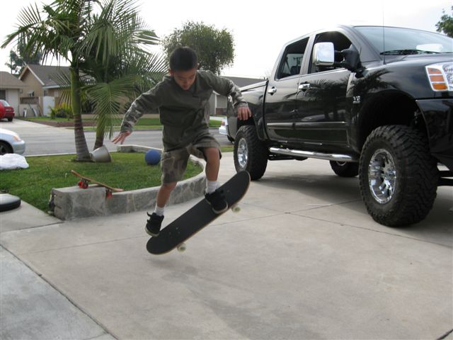

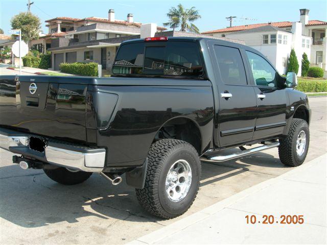

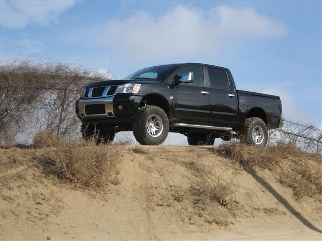

Here are some pics for my other truck (I traded it in for the 4runner 3 days ago). I had it with BFG A/T and later with Toyo M/T
Sorry for the picture of Toyo M/T. I couldn't find a better one.
