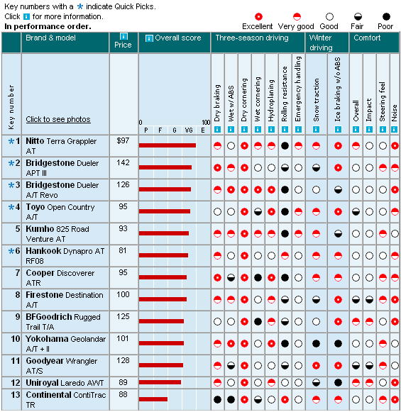

Tirerack needs to do an AT tire comparision. This is from Consumer Reports. No KO or MTs.
