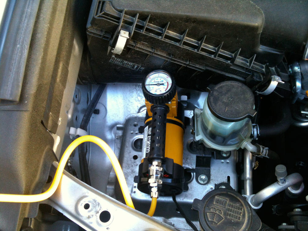

got tired of air compressor taking up space in rear so I mounted it in engine compartment . inexpensive a/comp I got from Pep Boys a few years ago . does a good job airing up tires after the beach (portable tanks work much faster but eats up space).
parts used: 2 heavy duty cable straps , 2 strips 1" x 2" foam rubber , cigarette lighter plug with rubber cover (marine type), inline fuse holder .

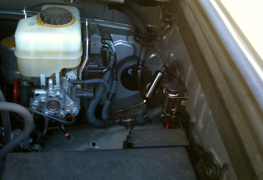

mounted a/comp next to a/c filter box with 2 cable straps through existing holes on plate next to power steering reservoir , used rubber strips doubled over to keep sharp metal edges from digging into straps. the compressor has rubber feet to isolate vibrations & I did not have to over tighten straps to keep unit in place. ran the power cord through horn area . installed cig lighter plug on existing tapped hole aft of the fuse box on side wall. ran positive lead with inline fuse (15amp) to bolt on positive battery cable , ran ground wire to ground wire of battery on sidewall.
the rubber cap keeps dirt & water out of plug area & compressor plug has it's own sheath to cover contacts when not in use . for safety sake I did not hard wire the unit or leave it plugged in.

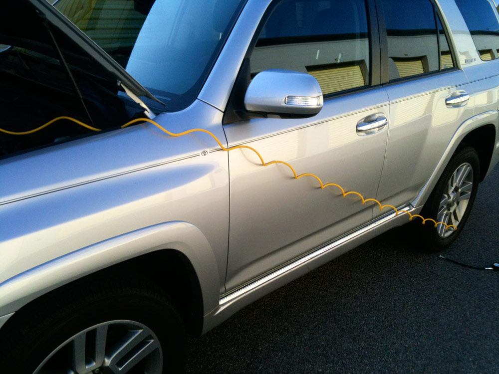

the air hose will reach the farthest wheel LR & has a threaded fitting so you don't have to hold it on the valve stem.
air hose is stowed in rear with the jack . the hose is plastic & I don't think it would fair well left under the hood with all that heat.
took about 15min to hook it all up.

I would highly suggest the orange rubber ARB air lines over the plastic ViAir ones . I had the ViAir and it gradually split near the end. Threw it away in Arizona it was leaking so bad and bought the ARB. It's a little more money but alot higher quality and you get what you pay for. .......http://store.arbusa.com/TIRE-INFLATION-KIT-FOR-ARB-AIR-COMPRESSORS-171302-P21322.aspx
Seems that you may not have a 25 footer. The OVERALL length of our 4 runners is 15.8 feet. And the OVERALL width is 6.3 feet. Assuming that your compressor is installed inside the engine compartment against the driver's side inner wheel fender, at least 2 feet or so from the furthest point of your front bumper, you can subtract at least 2 feet in length and another foot in width. Then, subtract at least 2 feet from the rear of the rear bumper to the tire inflation valve. In other words, you should be no more then 15 or 16 feet from your compressor to the rear passenger wheel.
Maybe it is the tight coil of the hose which causes you to loose length?
Length 189.9 in (4,823 mm) =15.833 Ft
Width 75.8 in (1,925 mm) =6.316 Ft
You may be right because my compressor isn't even installed. I have it sitting on the ground and it's a stretch.
Sorry, I was looking at another site, then made my post here.....if yours is on the ground and you still have a problem....then yea, I think your hose is way too short! Be safe.
