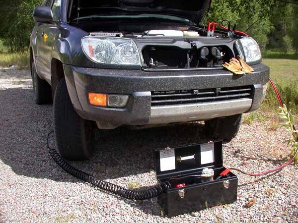

I went with the ExtremeAire Portable Compressor. It's 100% duty cycle and I've been using it for over 12 years.
(Note the leather gloves on my bumper. Those air chuck connections get HOT after 4 tires)
