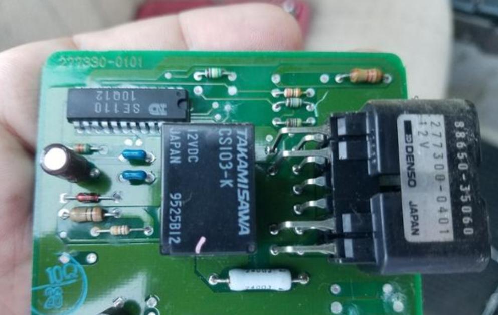

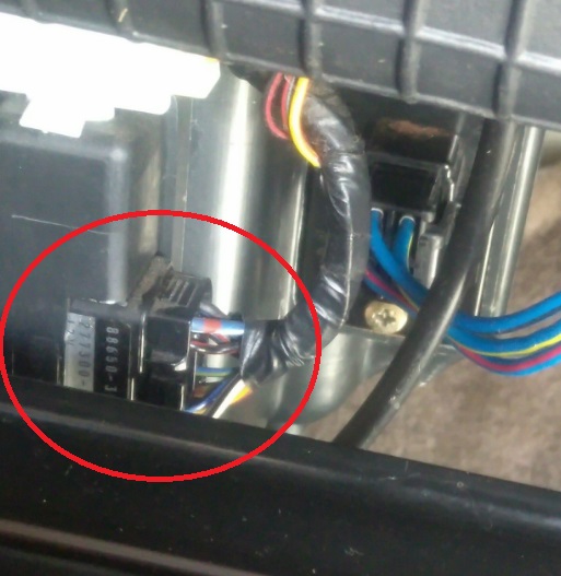

After some inspection I noticed right next to the blower resistor is a relay, which is tight and snug in their behind the cross bar. It was too difficult to remove without taking out the cross bar but I was able to stick my head in there and get a part number on the relay.
The part # is 88650-35060. "Amplifier Assy, Cooler Stabalizer" and other sites have it listed as "AC Amplifier Circuit Board".
Has anyone had to change this in their 4runner? Could this be the culprit?

**second photo is not mine, found it online**

Be glad they still offer this part at the dealer. If one has a Limited 99-02, this amplifier isn’t offered for sale anymore and you are up the river without a paddle.
Are the fuses sill blowing? It sounds like a loose connection somewhere.

Having never worked on a pre 99 AC system, I can’t say for sure but I have replaced a 96 Corolla’s AC amplifier because the system wasn’t working and no, the AC light wasn’t working. But it just was a no go for the owner one day. No moving of wires or replacing fuses helped. I believe we could see where the solder failed on the board.
I personally would look over the wiring and connectors more closely again.
