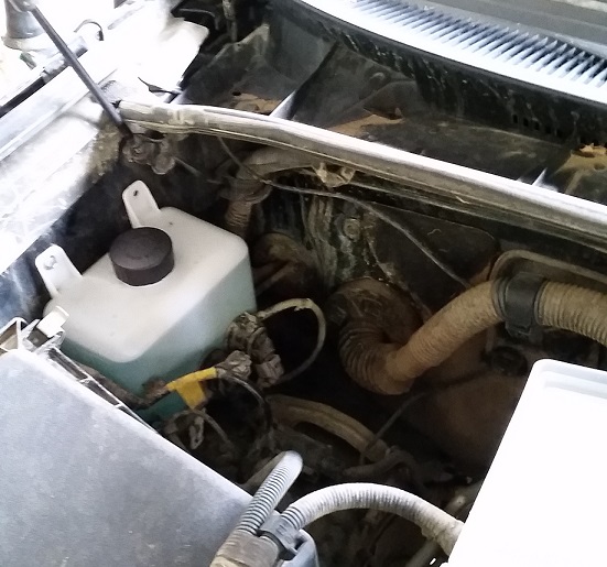

Windshield Reservoir Version 2.0
Well I couldn't do the redneck, zip-tied jerry can windshield washer reservoir anymore. For those that do decide to go that route - make sure you vent it. Otherwise it'll look like a mangled piece of plastic under the hood.
Bought this engine coolant reservoir off Amazon. It is much smaller than expected as their measurements were off but I'll see how much I fill it up. There's a plastic nipple on the bottom that you'll need to plug. I just used hot glue as that was all I had at the time and it seems to be holding the fluid with no leaks at all. Just drilled two holes (the size is escaping me at the moment), pushed the pump gaskets into place and then pushed the pumps into each gasket. I then used self-tapping screws to mount it. It's small and light enough that they should hold up. If not, I'll fab a bracket for it. Works like a charm and only cost around $30.

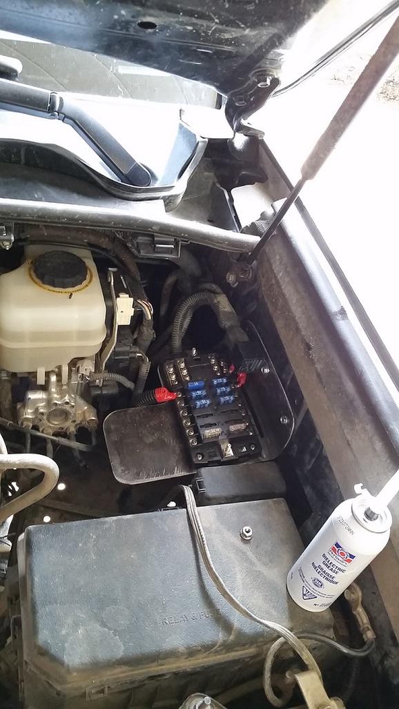

Blue Sea Fuse Block
Currently installing a 12 circuit Blue Sea fuse block.
Ordered a 100 amp waterproof CB off Amazon - still waiting for it to come in.
Fabricated the mount. Still needs paint.
I'm currently making the battery cables out of 4 awg and connecting within the next 1/2 hour. More pics to come!
