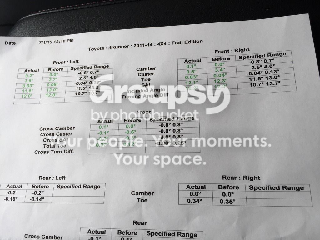

I recently got my tires and wheels installed and was initially experiencing rubbing at full lock when reversing on both front bumper areas (not fender liner, but actual bumper lip). I recently got an alignment and am experiencing even more rubbing on the front mud flaps when in full lock. Anyone have a solution to this? I already tried to take a heat gun to the mud flaps to flatten them out, but doesn't seem to help.
Is the only hope I have is taking it back to the alignment shop and maxing out caster to +4 and trimming the front bumper? Below is a print out of my numbers...

Is the "Actual" number what they set it to? If so then you're alignment appears to be right on the money.

I have 17x8.5 wheels wrapped in 285/70/17's.
short answer: yes. take it back, have them max out the castor. even with stock upper control arms they should be able to get more than that. there are plenty of threads about how to pull the liner forward and trim the mud flaps as well. I run 285/70/17 on 17x9 and still get a bit of rub on the body mount, but it is minor, and only at full lock in reverse.

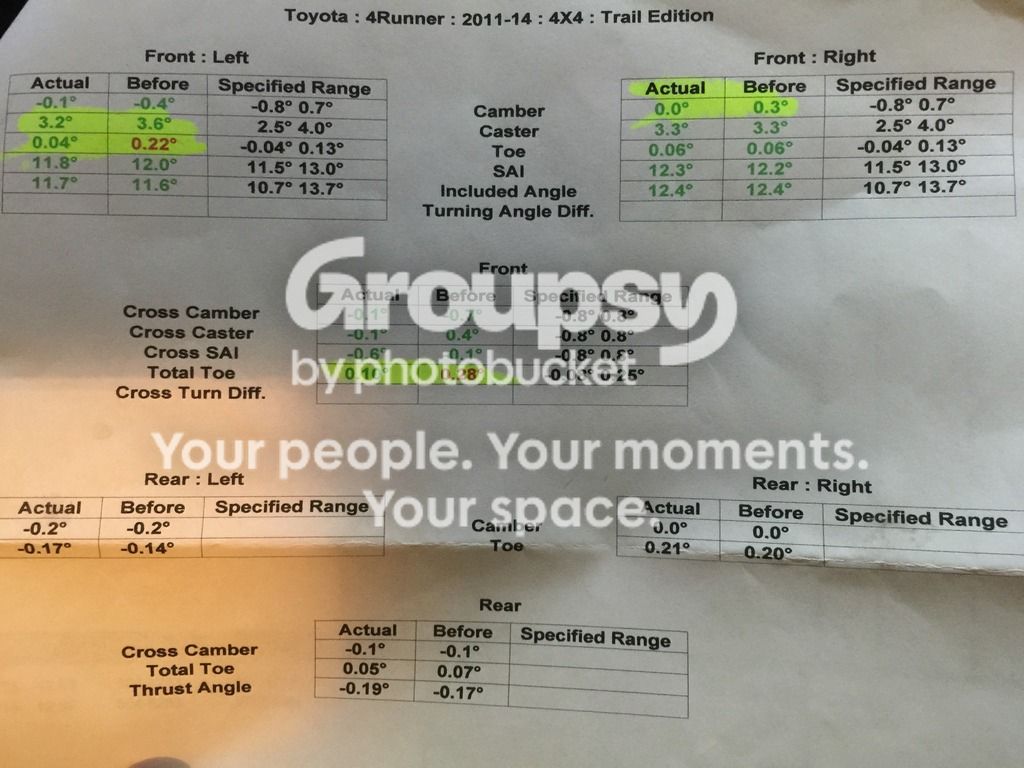

So I brought it back today and he said my caster is maxed out on both sides...looks like the most he can give is 3.5... Does that sound right?

it could be. once camber is established, you can then make adjustments to the caster. camber being more important takes priority, though the adjustments for both come from the same place.
if you use most of the adjustment getting the camber into spec, that doesn't leave you much room for a caster adjustment.

So is it even possible to achieve +4 caster?
This should be a tiny adjustment...

the distance from the UCA to the LCA is less than 20".
a .5° change will only be <.17" Not really worth it even if they could do it.
On that same note I had to cut the hell out of my mudflaps. Is what it is.
