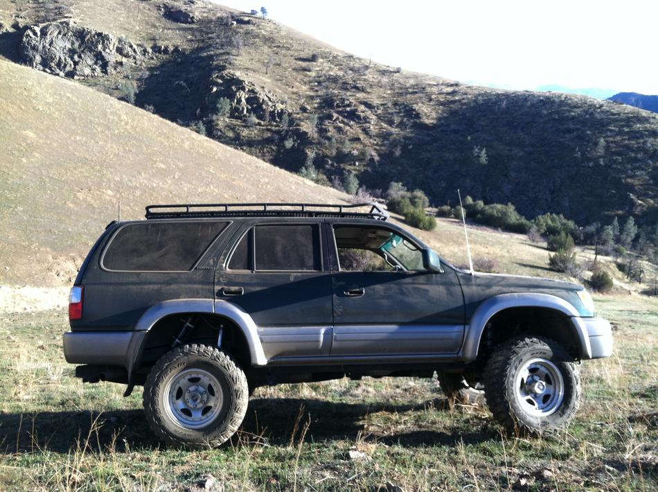

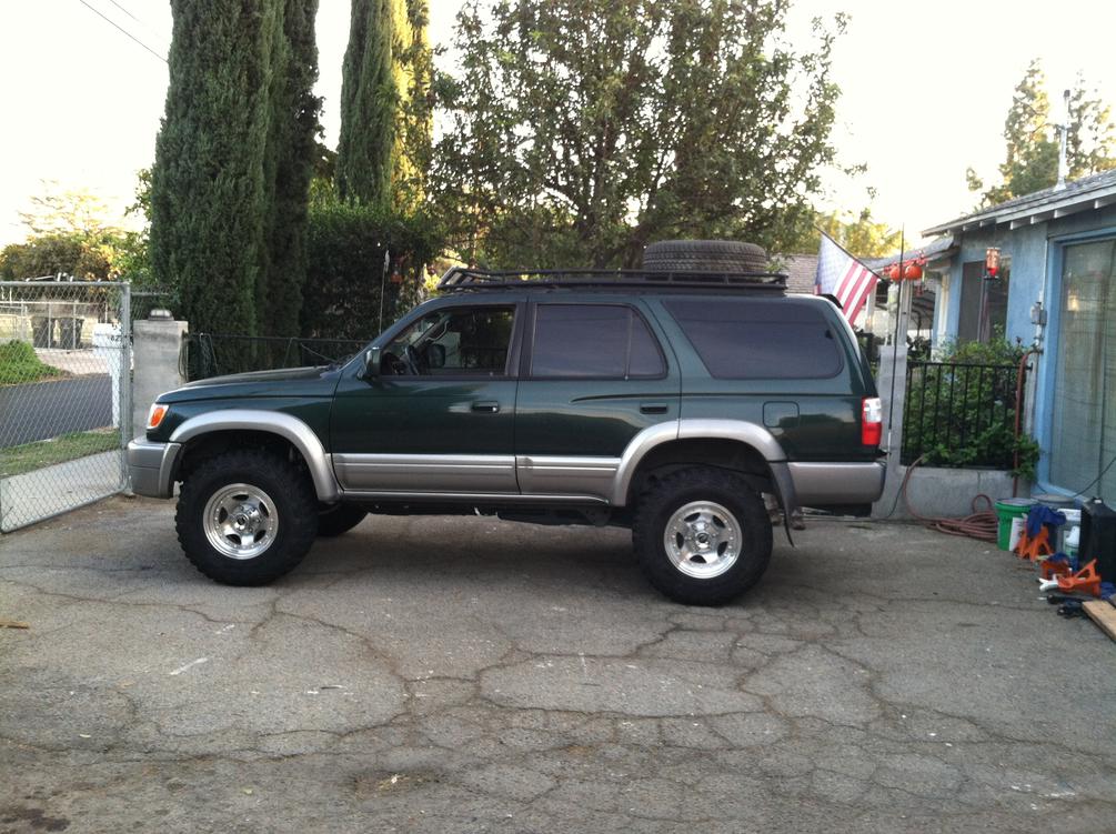

I had those wheels at one point with 265 75 16 and never had any issues. I never used hub rings or anything and no vibes.
I'm not saying it's not a bad idea to use them just throwing my experience out there
