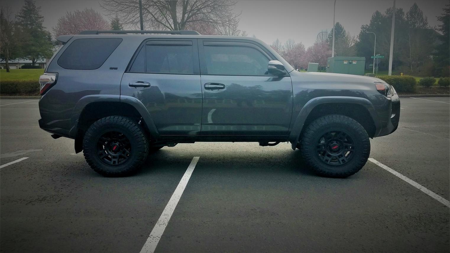

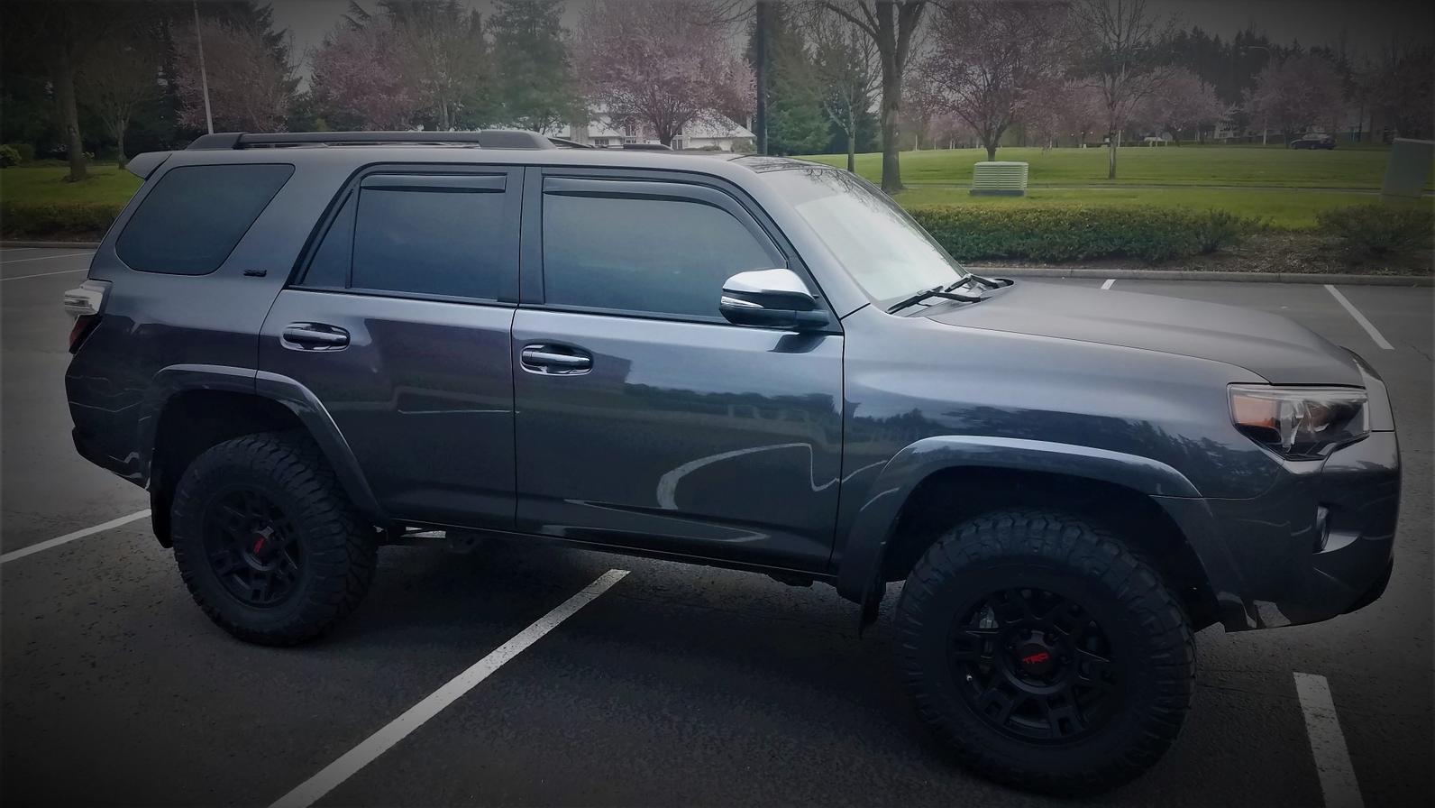

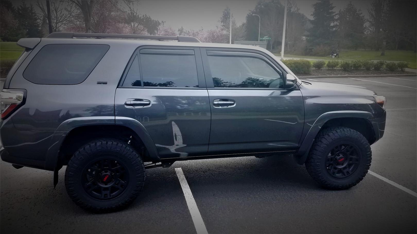

Bilstein 5100 front/back installed. 1.75" setting with 1" spacer in the back. 265/70/17 nitto ridge grappler.

I'm still on 5100 front and rear. Setting was 2.5fronts on stock springs and 1.5 on daystar spacers with stock rear spring. Never had problem and alignment with no issues. Better ride quality less noise dive. More flex on trails
Now I upgraded to toytec 3" lift kit. On the the same 5100 front and rear, with 3" toytec spring and 1/2" spacers. And superflex 2" rear springs. And again no issues at all. I upgraded due to 120lb steel bumper and RCI steel skid plate. The toytec 3" lift kit supported the weigh down. Same flex. More flex in the rear.
Tho I was told if i did the boss kit from toytec, I would have to do upgraded UCAs.
How it's sits:
