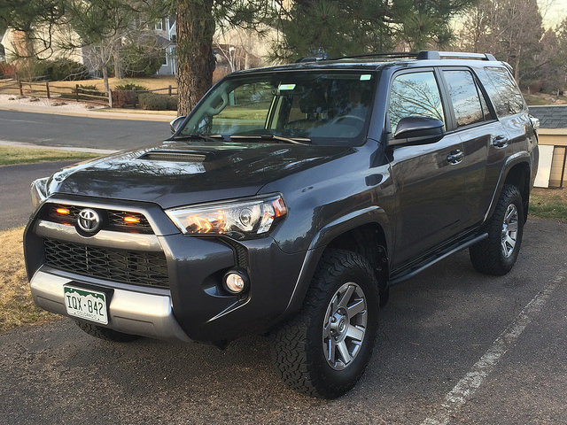

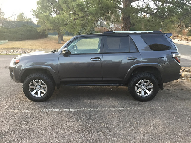

This has been a very helpful thread and it helped me find exactly what I wanted:
  • Bilstein 5100 on all 4 corners
  • Front set 1.75
  • Cornfed 1" spacers in back
Install and alignment by the famous RSG OffRoad in the Denver area. Here it is riding on BFG KO2 265/70/R17:

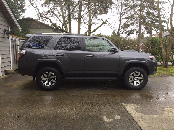

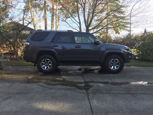

Got the Bilstein 5100's front and rear installed today and an alignment fronts set at .85" no other spacers etc 265/70/17 General Grabber AT2s. The Bils firmed up the ride a little the biggest benefit is the significantly reduced nose dive when braking, it's hard to tell from the pics the truck sits closer to level with a slight nose low rake not really nose low like stock. Very happy with the result money well spent.
Fender measurements at the center of the wheel.
Before:
Drivers front, 34.25"
Drivers rear, 36.50"
Pass front, 34.50"
Pass rear, 37.00"
After:
Drivers front, 35.50"
Pass front, 35.50"
Pass rear, 37.25"
Left pic before, Right pic after.

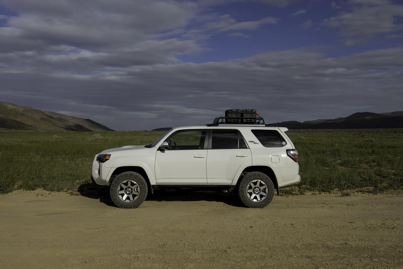

[MENTION=147757]GearJunkie88[/MENTION] Here is my rig with about 250lbs in/on it. This is before I added the Shrockworks sliders but they didnt make any difference to the ride height.
This is 5100's all around, set at 1.75 in front on stock coils, and wheeler t13 coils in the back.
