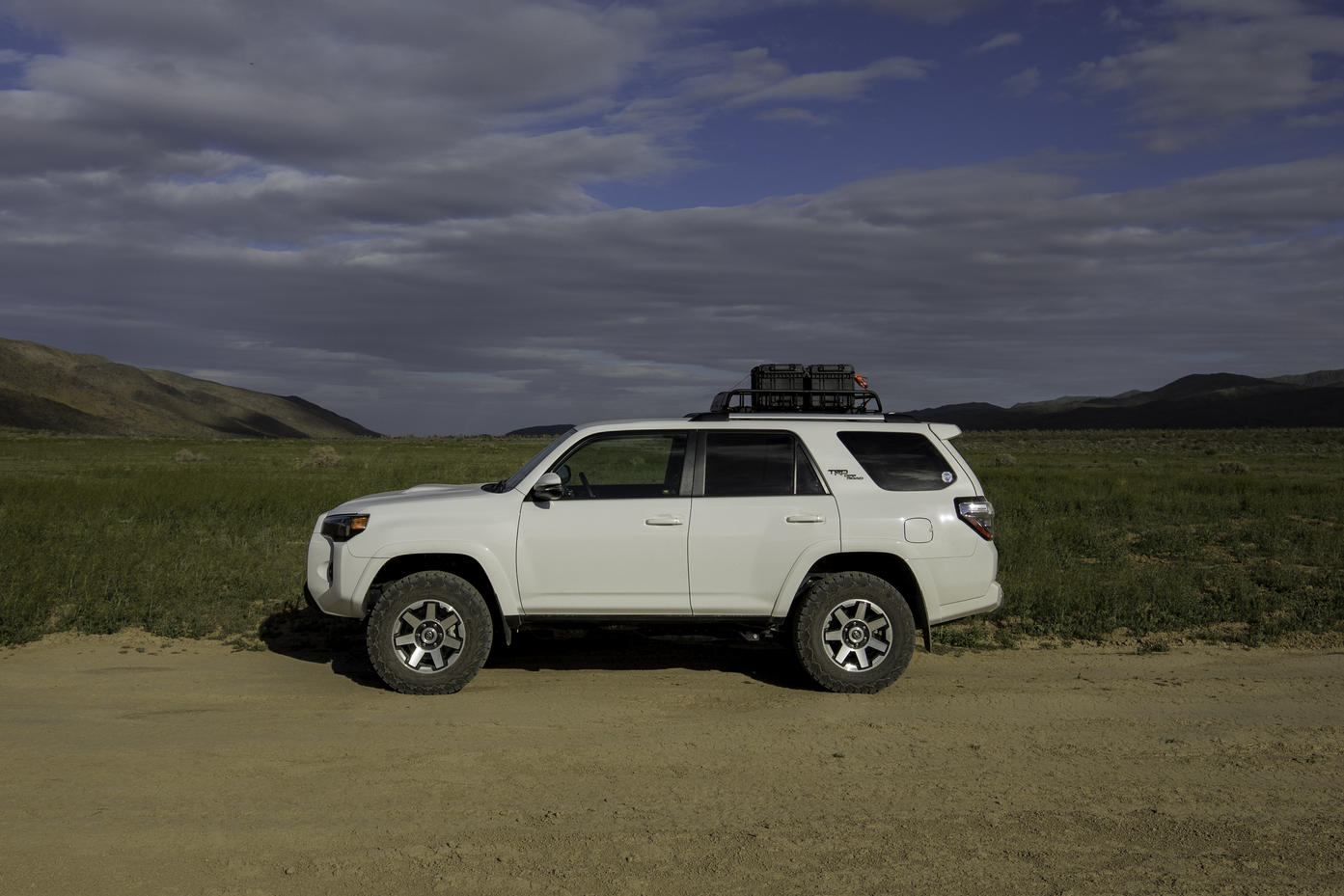

5100s set at 2.5" front with cornfed 1.5" rear and airlift rear springs. 285 K02's
IMG_0539_1.jpg~original
Stock UCA's? 285's rub?

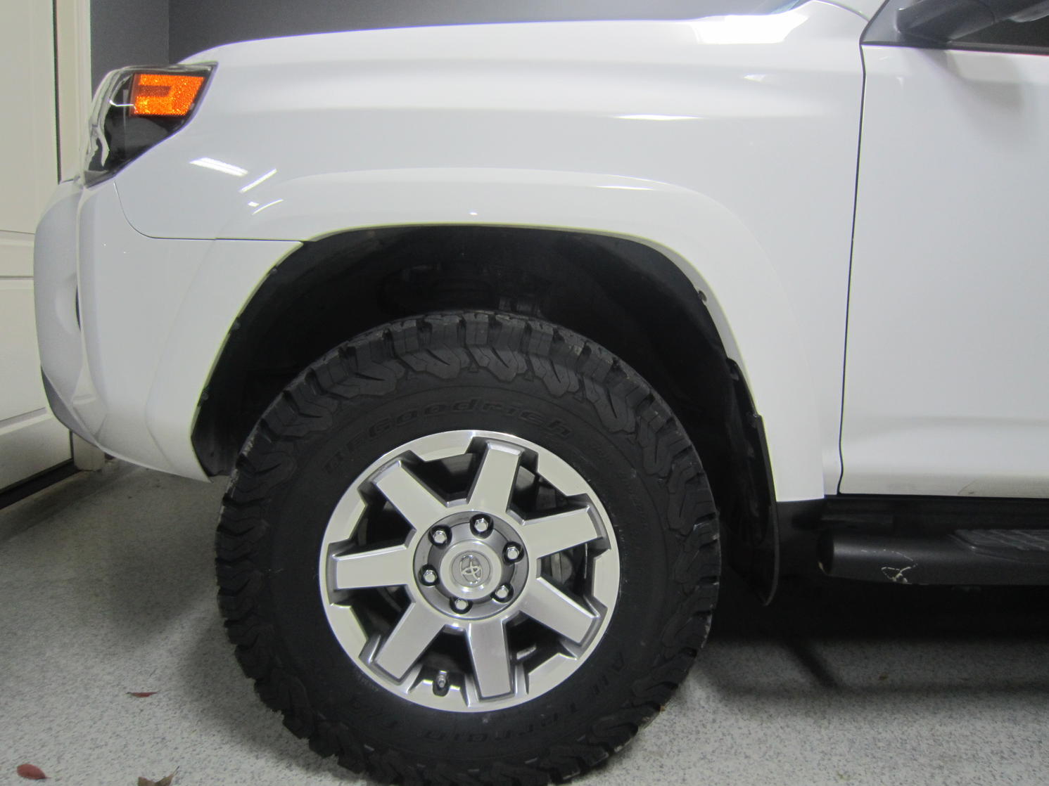

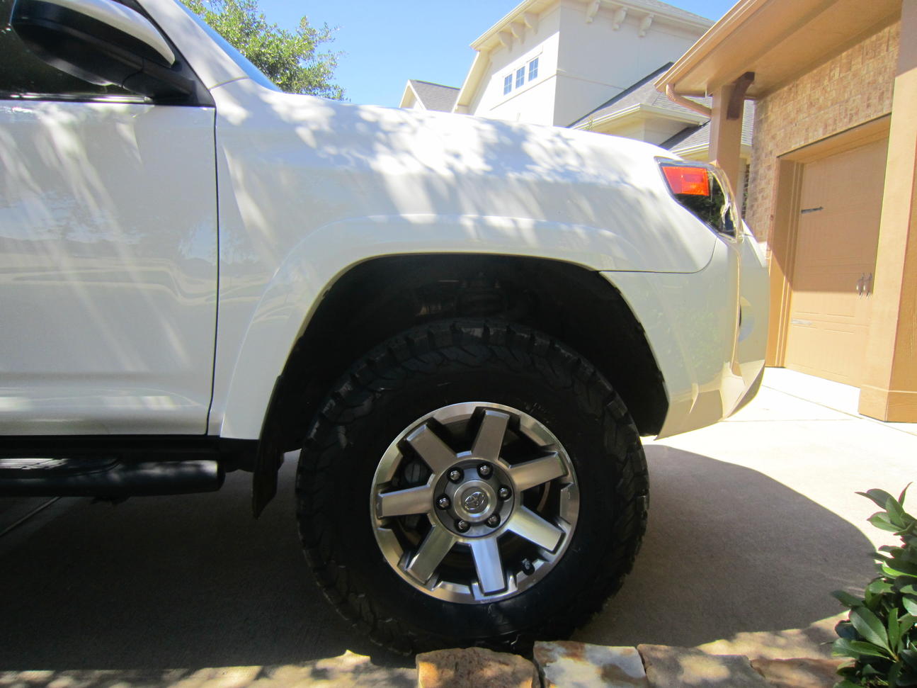

2015 Trail lift

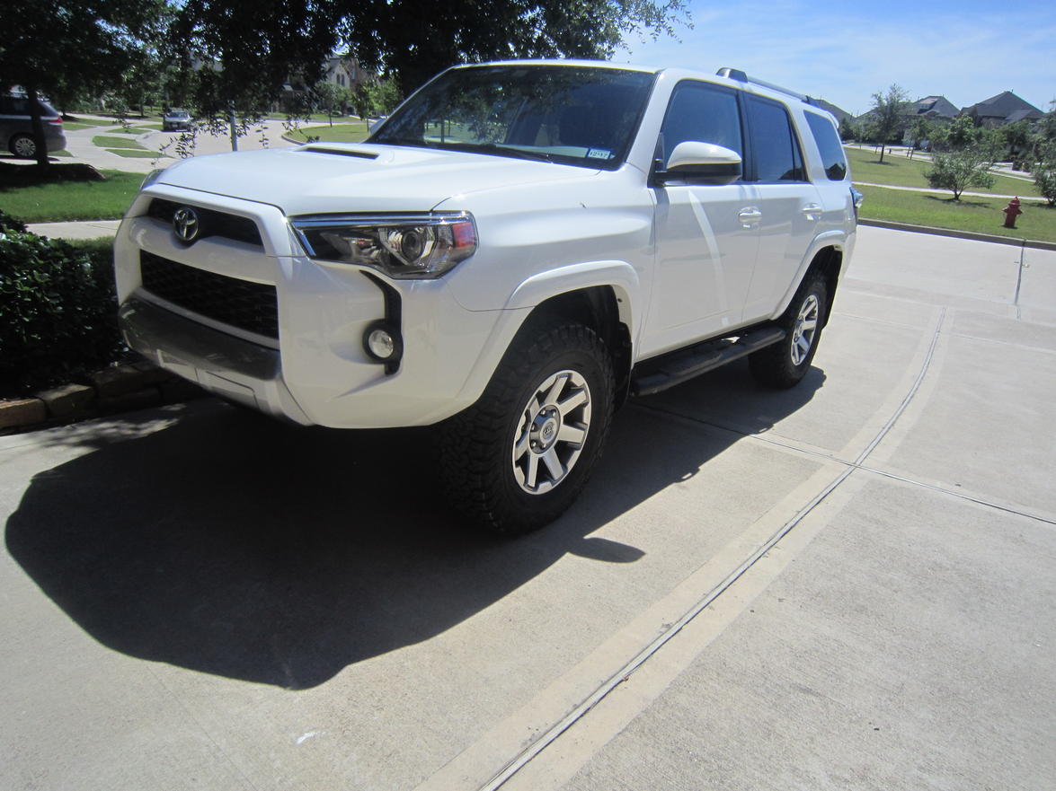

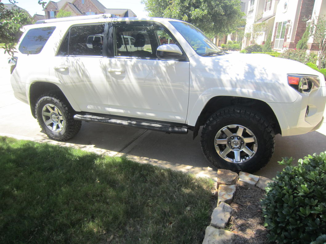

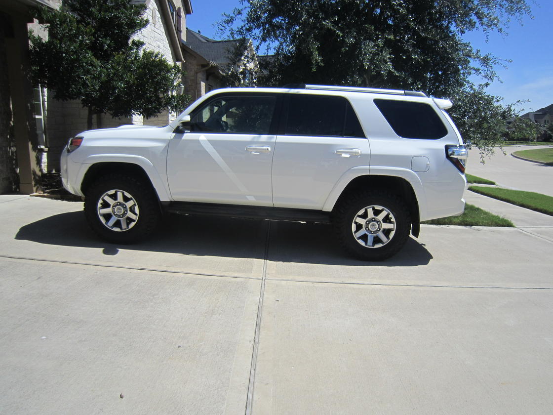

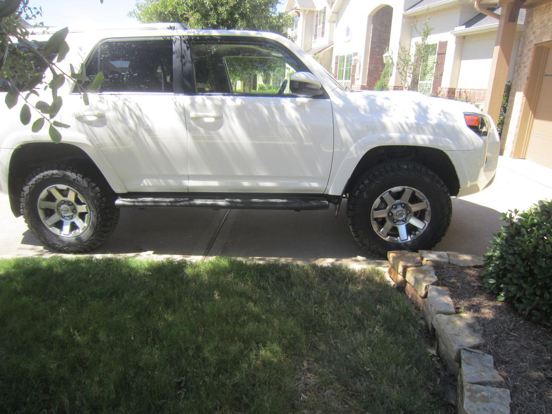

Just installed 5100's set to 1.75" and the 1" corn-fed rear spacers a couple of weeks ago. As most have said, defiantly looks nice; but it's a sporty feel compared to the stock shocks. The rear can bounce around on bumpy roads as well. Off road is much stiffer, I'm not sure if I like that or not, but overall it was a nice upgrade.
I also got a set of BFG KO2's in 275/70r17 installed yesterday. They look good and gave me just under 1/2" at the fenders, so that was nice. Again, very stiff off road. Something I'd have to get used to I guess.
Overall cost was $1701. Gas mileage after lift but before tires was down less that 0.5mpg. 10 ply tires should eat up maybe 1 mpg? My advice to anyone thinking of doing this is stick with the lighter tires & maybe just set the front shocks to 0.85" & forget the rear spacers. It is really nice looking though. This advise is from a 42 year old married father of 2.

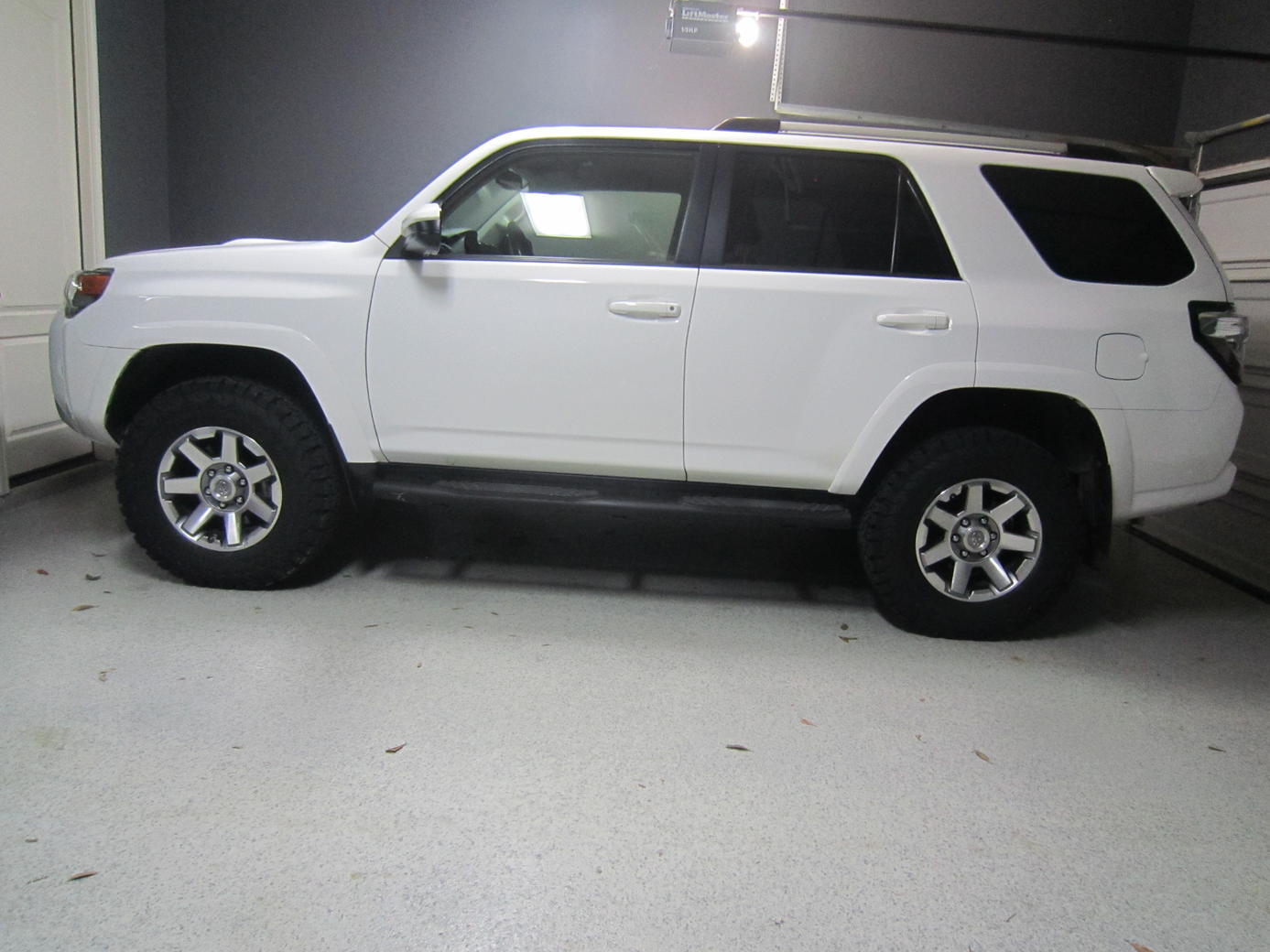

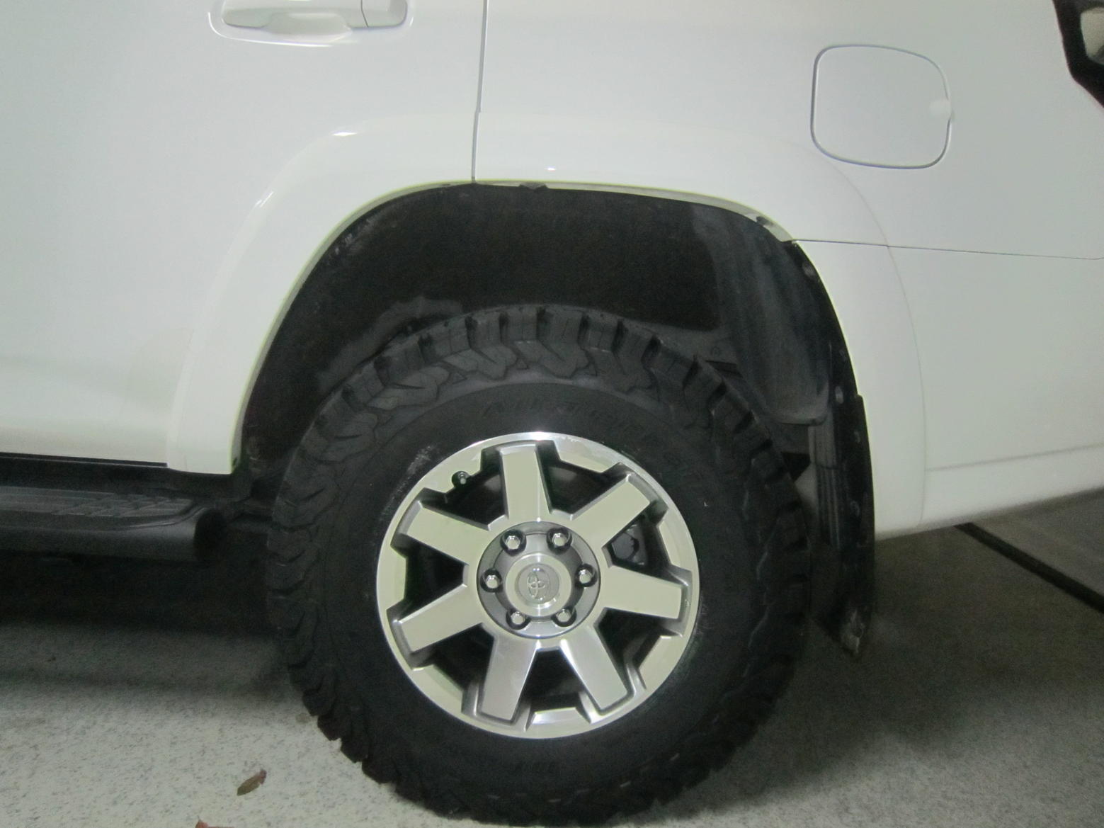

This is with about 250 lbs in the back

You sound like me & you'd be right; the rear wheel well would look large with a 265 (it looks a little large with a 275). These Toyota's are kind of goofy looking from the rear anyway. People will tell you that there is only a 0.3" difference between 265 & 275, but I put them side by side & there was a noticeable difference in size. HIGHLY recommend the 275!
