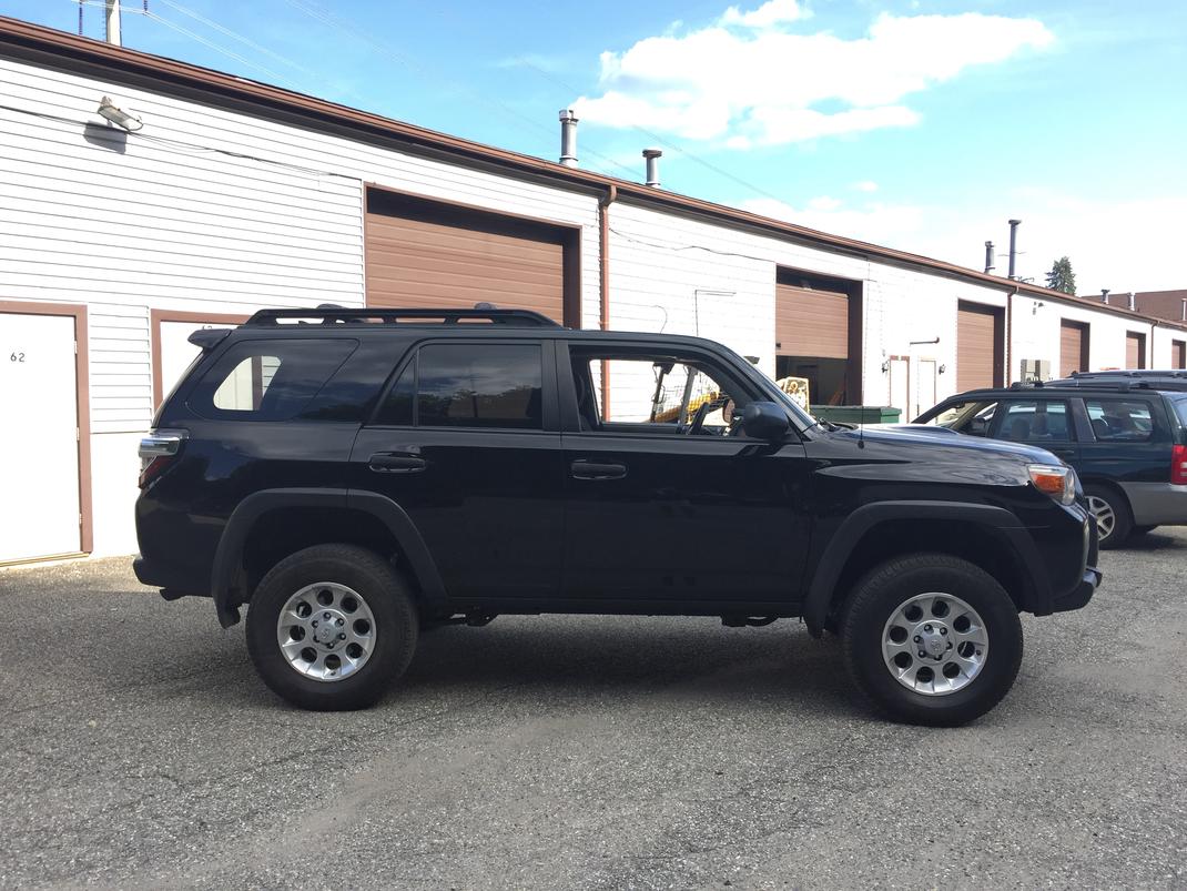

Been stalking these threads and finally pulled the trigger: Billstein 5100 all four, 1.75" setting, Dobinson's 599 rear springs for 1" rear lift and Falken Wildpeak AT3W @ 285/70r17. It looks much better in person than in pictures. I am totally happy with this set of upgrades, but only one day of driving so far.

Looks great! Any rub? I'm going the same hight as you in the front and back but one tire size down. (275) The rims I got are a bit wider though. The FN f(x) which are similar to the Pro's but lighter.

Looks awesome! I have the 5100's set at 1.75" and went with 265BFG's but kind of regret not going bigger. Oh well, maybe once it needs new shoes again.
