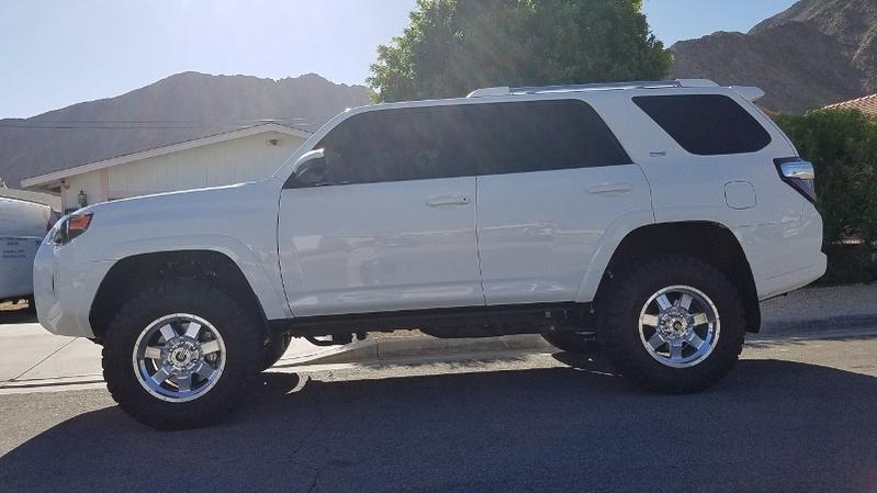

[MENTION=147757]GearJunkie88[/MENTION] Here is my rig with about 250lbs in/on it. This is before I added the Shrockworks sliders but they didnt make any difference to the ride height.
This is 5100's all around, set at 1.75 in front on stock coils, and wheeler t13 coils in the back.
This is the exact setup I'm currently considering for mine. How much lift did you get from the T13 springs? Any additional photos?

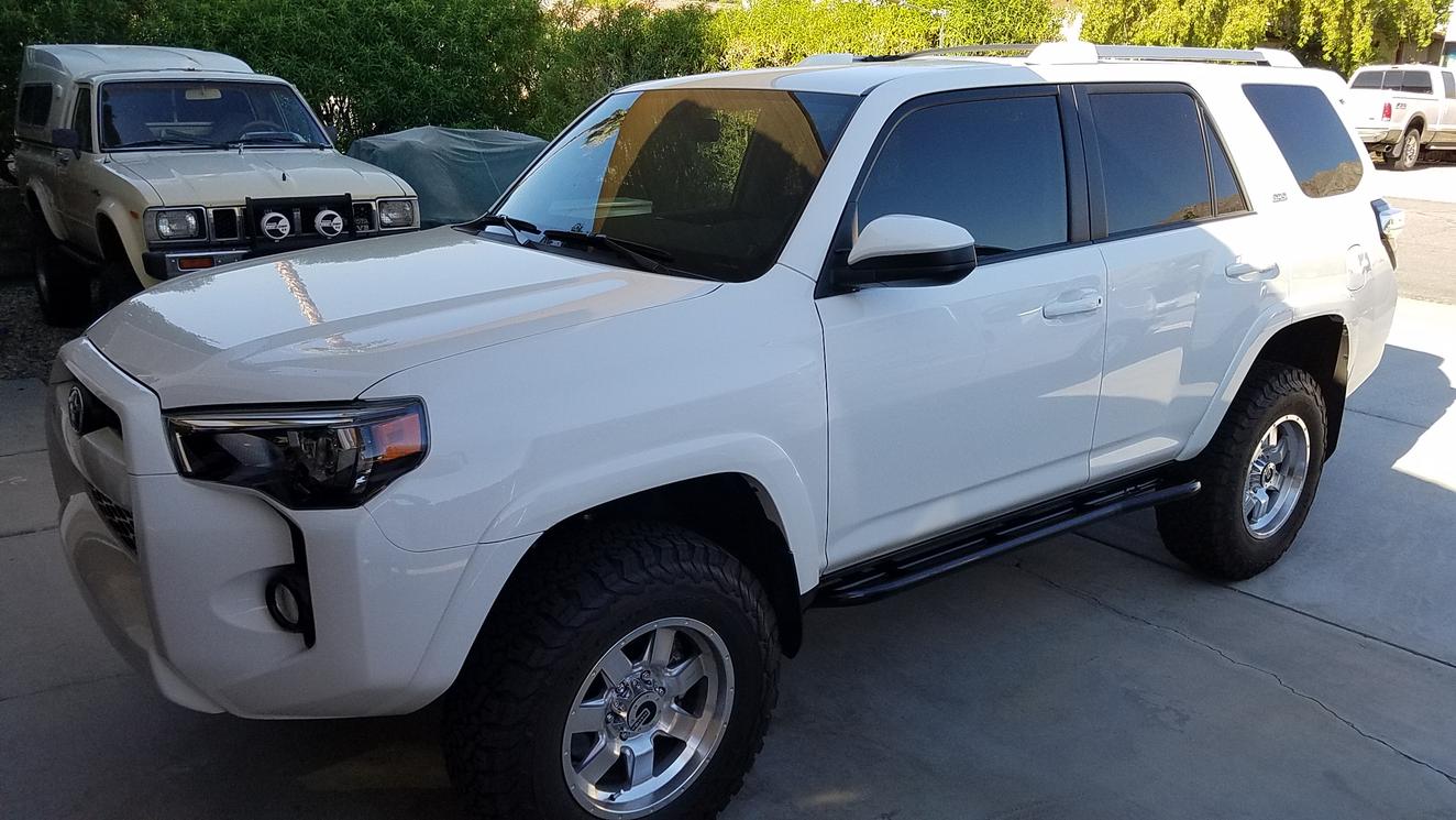

Got my 5100s on this week. Decided to go 1.75 with stock springs up front and T13s with one OME 10mm spacer on the driver's side. Whoever made the call at Toyota to spec the 4R with those charmin ultra-soft shocks should really question their decision making ability. Ride and handling are vastly improved over stock, the hype is real.
Before:
After:
My before measurements were 20 1/2 RF, 20 LF, 22 RR & LR. After measurements are 22 1/2 RF, 22 3/8 LF, 23.5 RR & LR. The alignment shop came out to .1 deg camber on both sides with 2.2 deg caster on the left and 2.3 on the right. I'd like to see a little more caster, so I'll take it back and get it tweaked after everything's had a chance to settle in a couple weeks.
