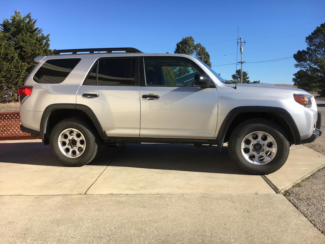

Here's my setup:
5100s front and back.
Front set at 1.75
Rear 1" Cornfed spacer.

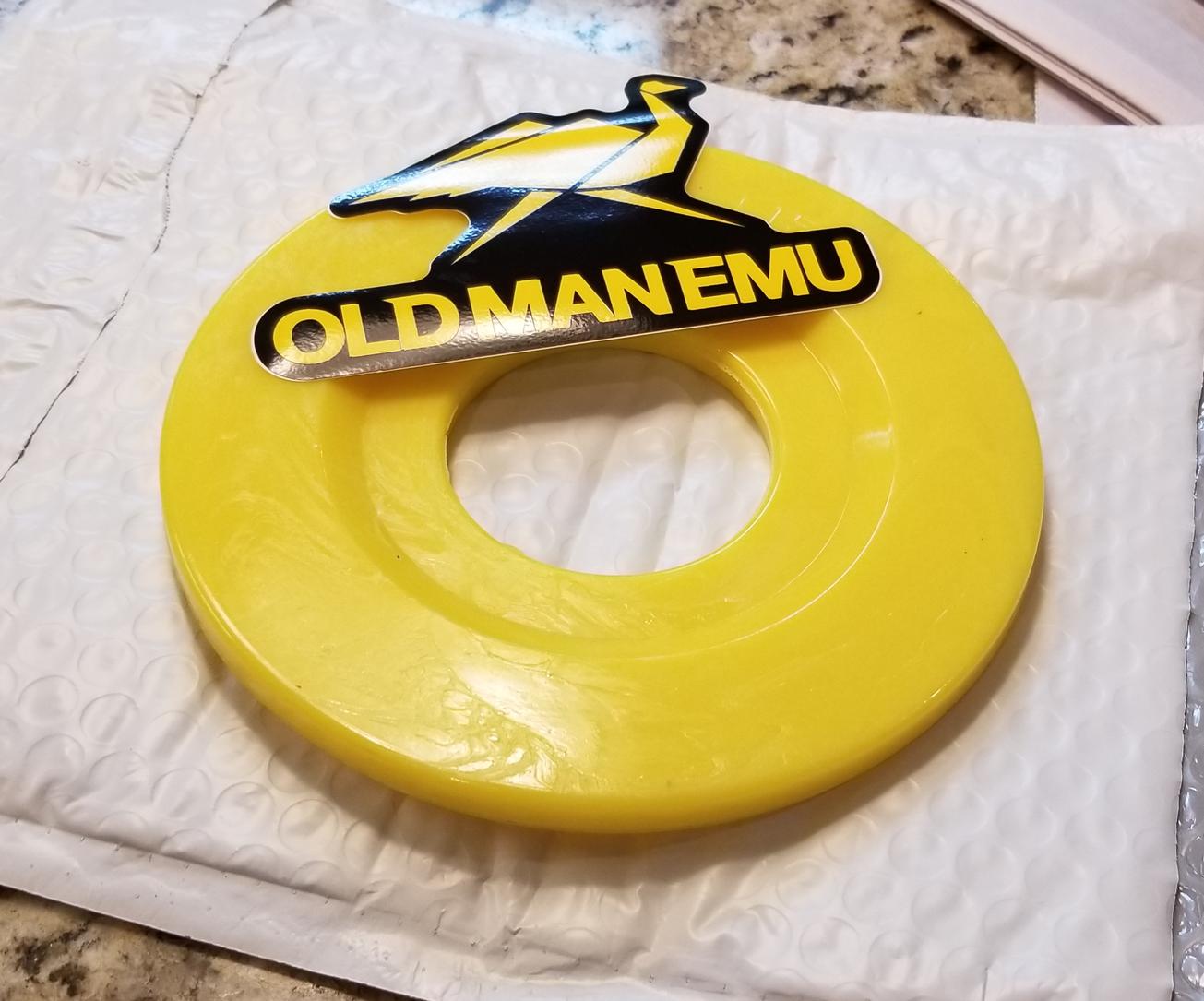

Hello Guys,
Here's my current setup:
Fronts 5100's set at lowest setting with OME 884 springs
Rear 5100's with Icon springs
Leans too much and I bought this 10mm OME spacer (see best OME spacer pic ever) to remedy.
Am I on the right track to take care of the lean?
Also what is the safest was to add a little more height in the front?
I understand adjusting the shocks up is possible but not recommended per Bilstein. Would there be another way without causing additional wear and tear on the other parts? Note - I am adding UCA's.

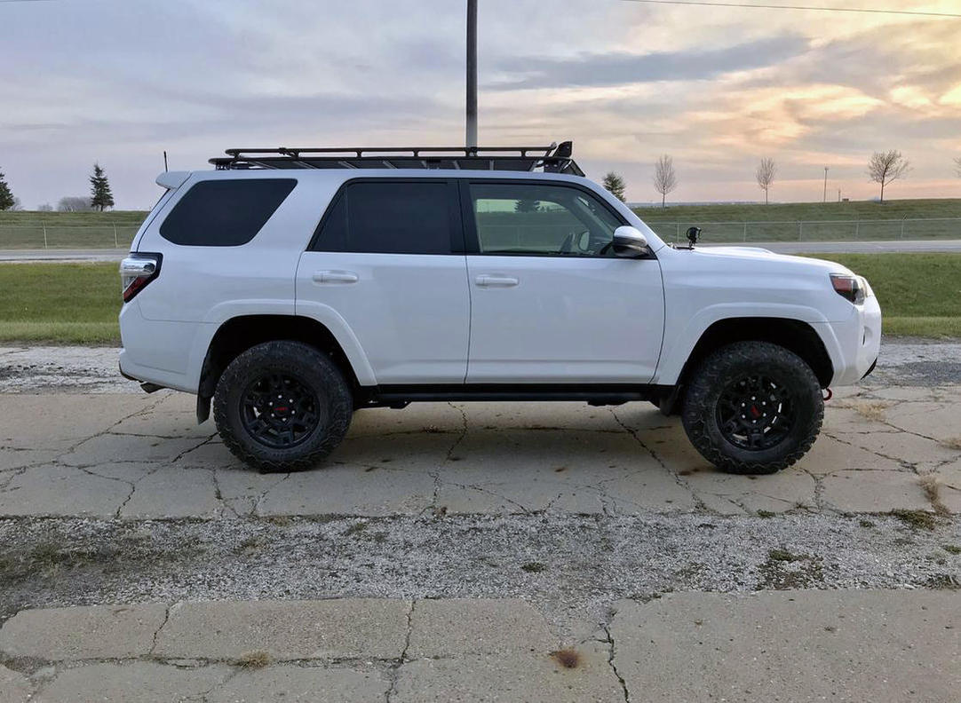

I really like the height of the 5100 on all for corners with the fronts set at 1.75 and having a 1 inch cornfed spacer in the rear. But I would rather set the 5100 at 0 and not use a spacer and use springs instead to achieve this look. I'm in a 2018 SR5 with 275s on TRD pros. Can any recommend what springs to pair with the 5100 to this height. Pics would be helpful also. :thanks:
I'll try to post pics later, but I just added the Toytec Eibach springs for 1.5" of lift and set my 5100s at .85. It came out perfect at about 2.5" total lift. Enough to look good, give more travel, and don't need new UCAs. I'm going to add some Dobinson springs to the rear to net 1.5" of lift. Right now I have 1.5" spacers and airbags. The airbags make it a super stiff ride and I don't get as much travel as I would with the longer springs.

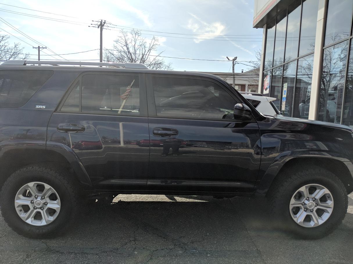

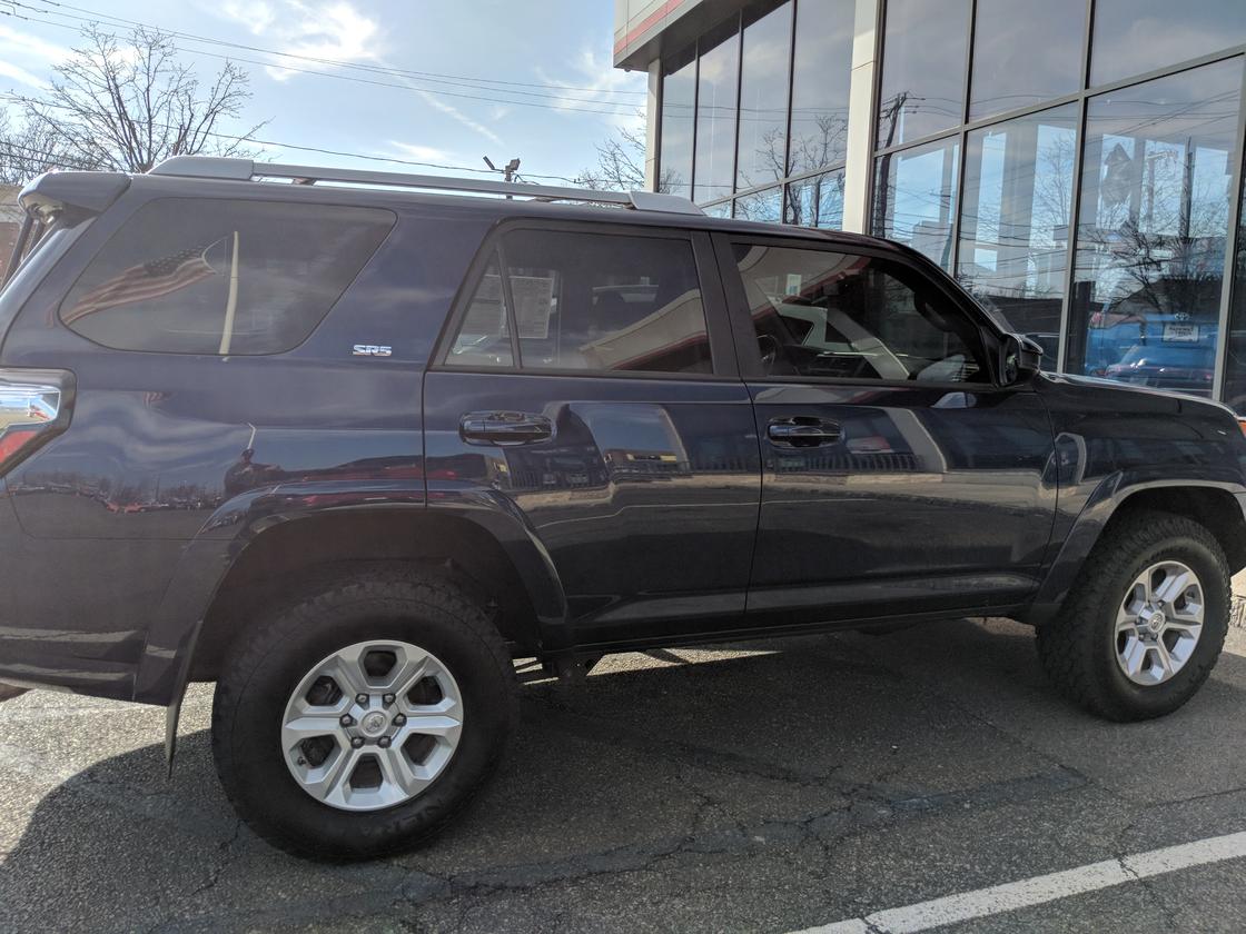

Hi guys. So I stumbled across this in my search for a used 4runner. It has 5100's all around. Can anyone advise how much of a lift you think it has? How would I know if he replaced the springs and if they're the hd versions? I want to put 285/70/17's on, but there doesn't seem to be much room between the uca and the current 265 tire. So I'd imagine I'd need new uca's. I was going to buy a base one and put the lift and new tires on afterwards, but if the price is right, this one might tickle my fancy, just not sure if I should trust if the work was done properly (dealership doesn't know who did it. I might have a mechanic look at it).
.85 maybe....it honestly looks about like stock ride height.
