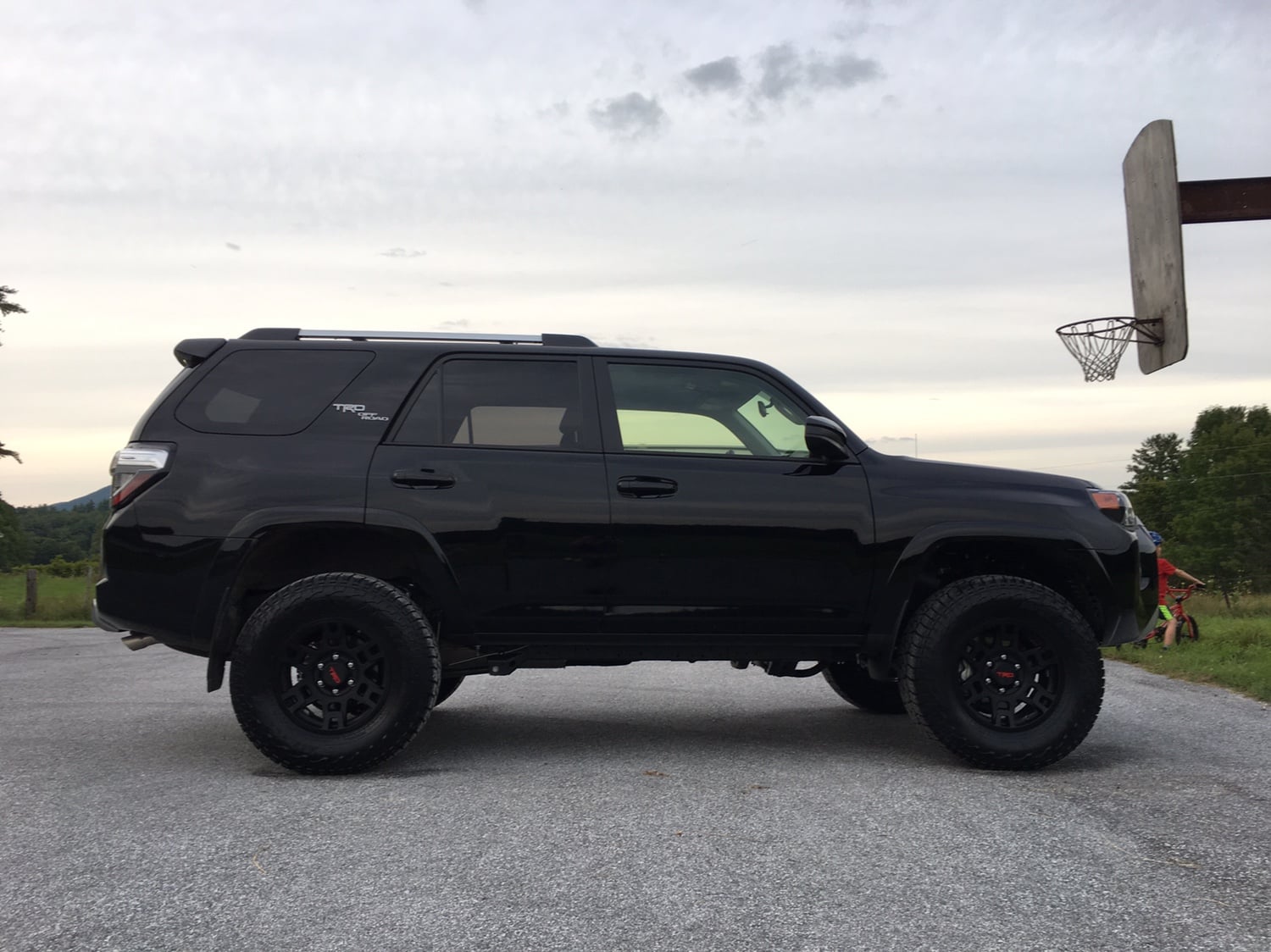

I had the 285 nitto terra grapplers installed with a 2.5/1.5 lift. I already trimmed the bumper and moved the fender liner forward and there isn't rubbing anymore even at full lock however I'm debating adding the spacers and just wanted to get an idea if further cutting will be necessary. I would be using the 1.25 spidertrax spacers. Below is the 4runner as it stands now.

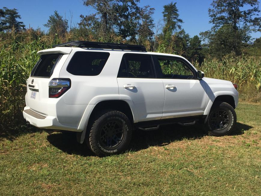

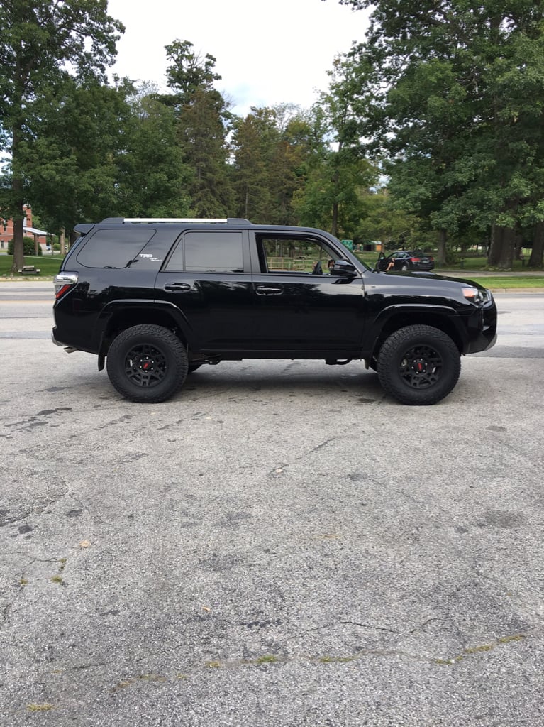

Been stalking these threads and finally pulled the trigger: Billstein 5100 all four, 1.75" setting, Dobinson's 599 rear springs for 1" rear lift and Falken Wildpeak AT3W @ 285/70r17. It looks much better in person than in pictures. I am totally happy with this set of upgrades, but only one day of driving so far.
Not sure if i missed it but do you have the wheel spacers installed in these pictures? The 4runner looks awesome!

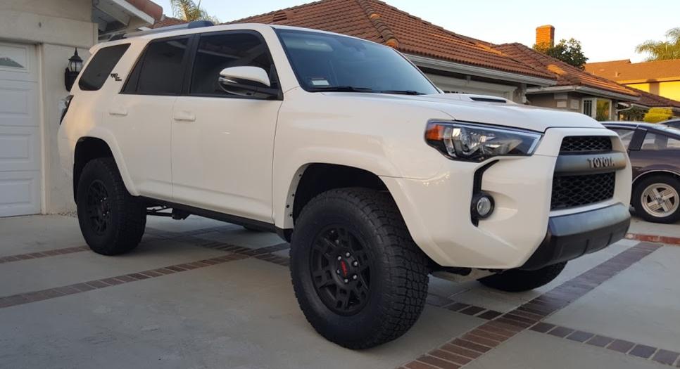

Afternoon folks! installed @ 2.5 front last night with stock springs, and toytec 2 inch in rears.
visually i can see some positive camber; will a trip to get an alignment correct this? Or do I need to get some upper control arms with additional camber adjustment?
F Photobucket - and I had some serious camber as well. I had it aligned with stock UCA's and mine were able to be put back into spec.

The lift changes everything about your front suspension geometry, so all your alignment specs will be way off. Best to get it aligned soon, or your tires will wear prematurely.
Bringing camber back into spec after a lift usually isn't hard. It's reduced caster that's the problem with stock UCAs, and which aftermarket UCAs address.
Some folks (including myself) don't mind how it drives with reduced positive caster and stock UCAs. It tends to be a little more wandery on center. It's really up to you. Tire wear is not affected.
There are a zillion threads on T4R about this -- a bit surprised you haven't seen them if you've been a member since 2011.
thanks for the info! will hit up an alignment shop asap.

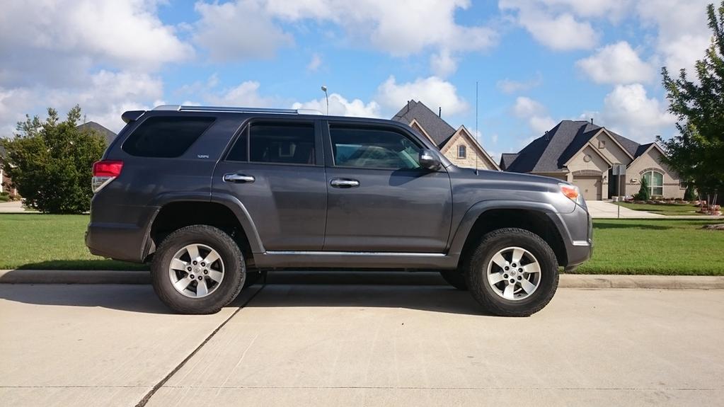

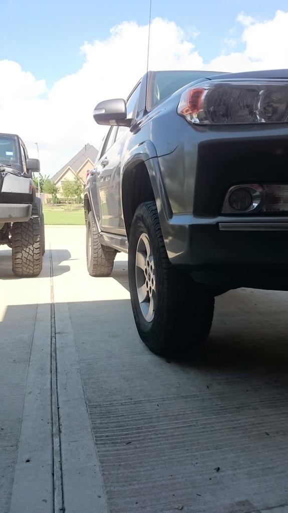

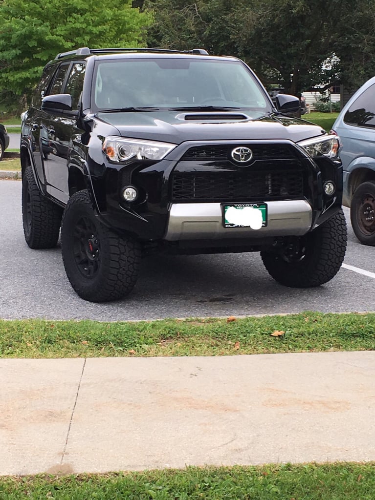

Attached the pictures I intended to post...2.5 in front (stock springs) and 2 inch Toytec springs in back. 275/70/17 Cooper ST3's.
Lift height is higher than i expected...but I do like the leveling that it came out to be.
Planning for some wheels next....17x8 -10 offset and perhaps up sizing the tires dimensions. 285's, or maybe stick with 275 with more aggresive tread pattern.

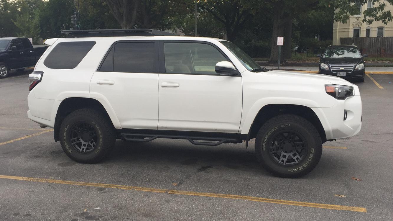

Pics of my 5100 set at 1.75" with 1" rear spacers
This thread was super helpful in my decision making process so wanted to share my finished pics for anyone else searching for something similar. 2016 SR5, Bilstein 5100's set to 1.75" in front with 1" Cornfed spacers in back. FN F(x) pro wheels in dark gunmetal with 265 General Grabbers. Great stance with stock tire seize I think and great for a daily driver.
That looks awesome! How's the ride compared to stock? I am thinking of doing this exact same setup.

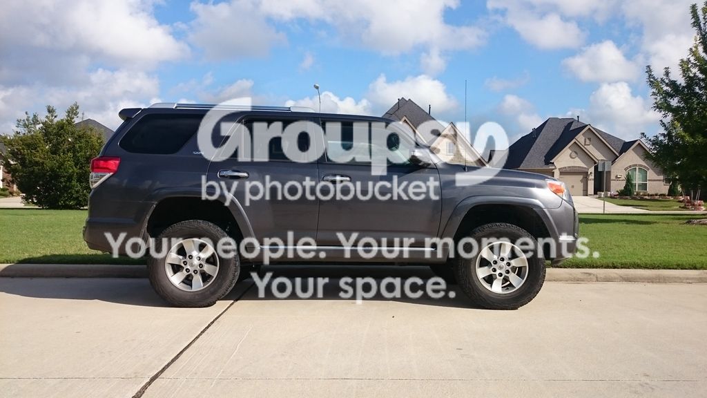

Just following up after alignment last week...camber looks good! but only a couple degrees caster on left and 1.2 degrees on the right.
This is with the 2.5 inch setting in front...fyi.

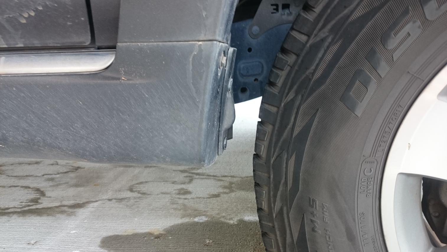

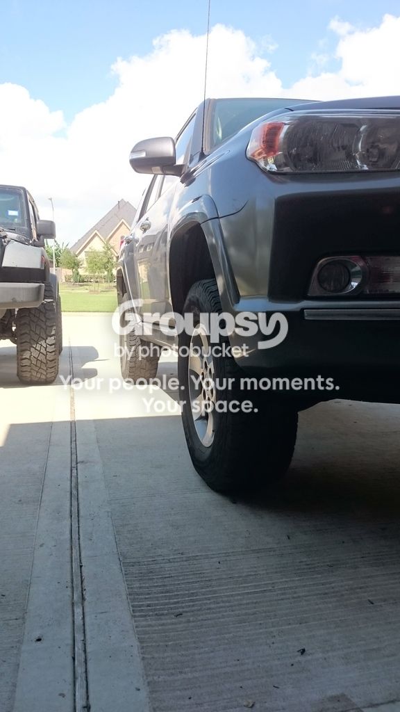

I have cooper at3 275/70/17's currently and am considering 285 duratracks.
Judging by the clearance i have now, will need to do the fender liner mod....but looks like i have some wiggle room behind the tire.
In the picture attached, that is as close as the tire comes to contact.
Me things i am good to go with the 285's....unless i am misunderstanding something?
Thanks for the help all!

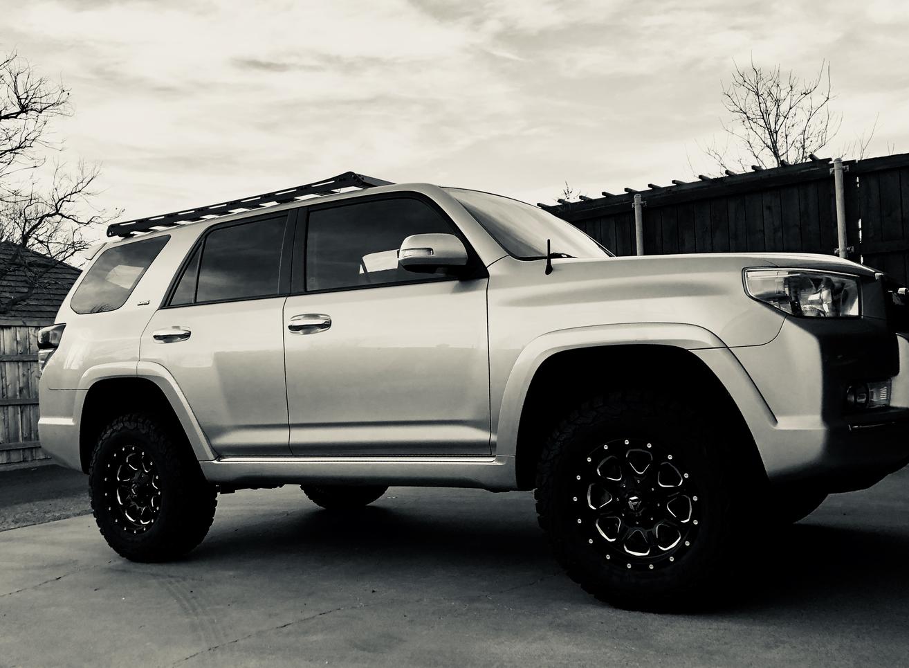

mods to my 2010
2.5 front billstein and 1.5" rear with new rims and tires and Prinsu Rack
