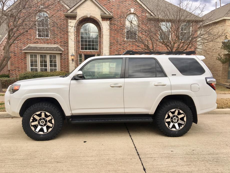

Better pic with the 5100's at .85
Folks...here is a better photo of the T4R post the lift/BFGs....this is just at .85, but has improved the stance quite a bit
Thanks for the pic! I think this convinced me to go .85 and 265ko2s. I’ve been contemplated the 1.75 setting with a 1” rear spacer and bigger tires. I know I don’t NEED it though. I like the stance on yours and my white trail doesn’t have running boards so it should look a little taller. Bilsteins will be here Thurs.
Did you consider going higher?
I have/did, but was just unsure of the route to do it...ideally u want to upgrade the UCAs (and maybe other components) the higher you go... I wanted to get the new tires and ladder with my remaining cash... Overall I am happy with the stance, and will consider cosmetic stuff next (legacy grill and black valance...maybe and HID conversion)....before going higher...
