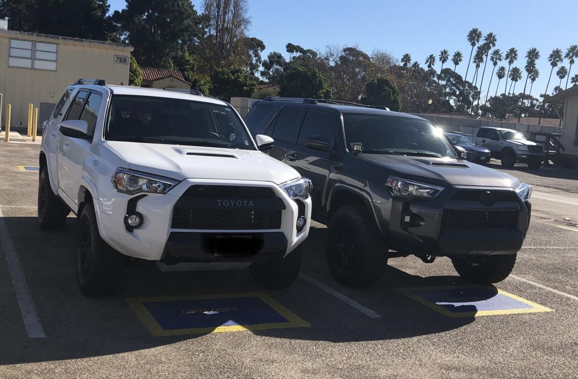

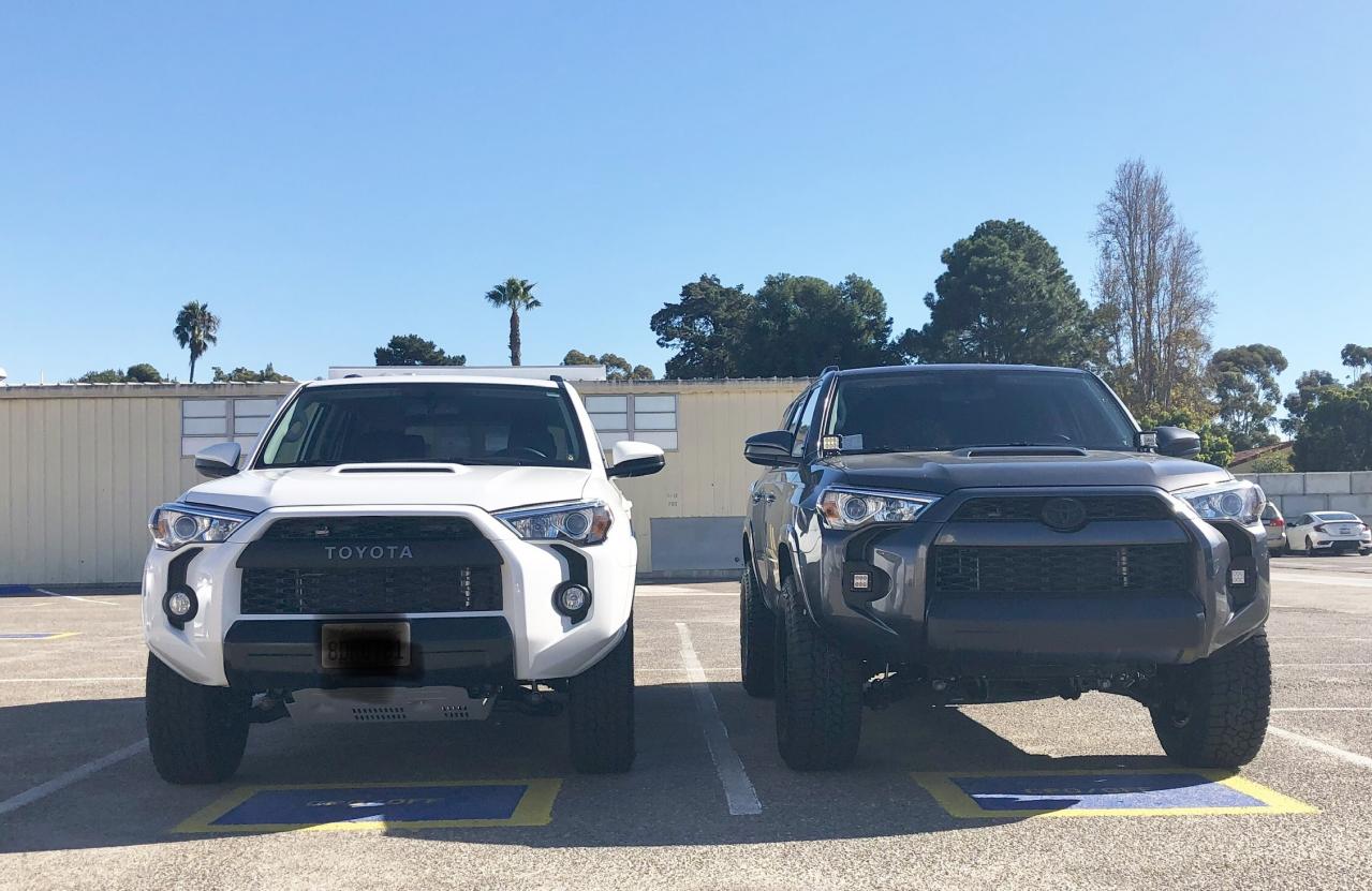

Just do the 5100/wheelers lift and be done with it. Spacers are garbage, and provide nothing for performance and ride quality. The way your 4R drives before/after is night and day, and the truck sits perfectly IMO in regards to rake. Here’s my Trail next to a stock TRD Pro for reference. 5100 front and back, T1/T13 Wheelers springs, front 5100 set to zero. I’m easily an inch to 1.5 inches higher than the Pro:

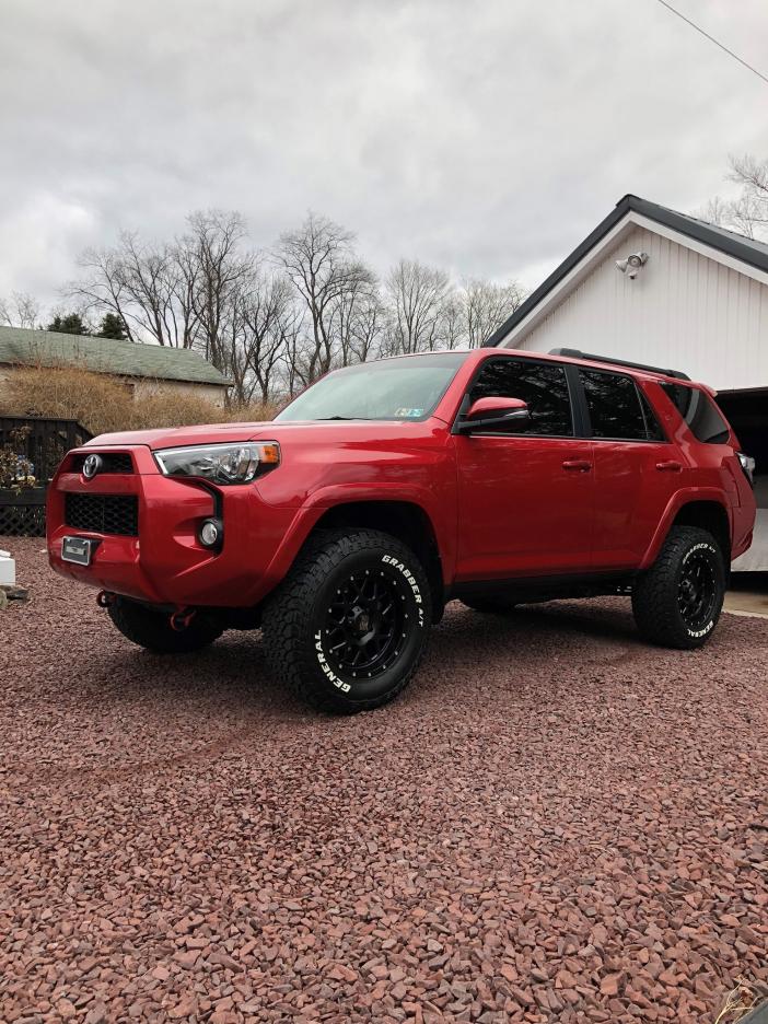

You put 5100's set at 2.5 in front with nothing in rear no way will that be level.Here is mine 5100 all the way around front set at 1.75 and 3/4 cornfed spacer in rear.Even at 1.75 with nothing in the rear the front sat higher than rear.
