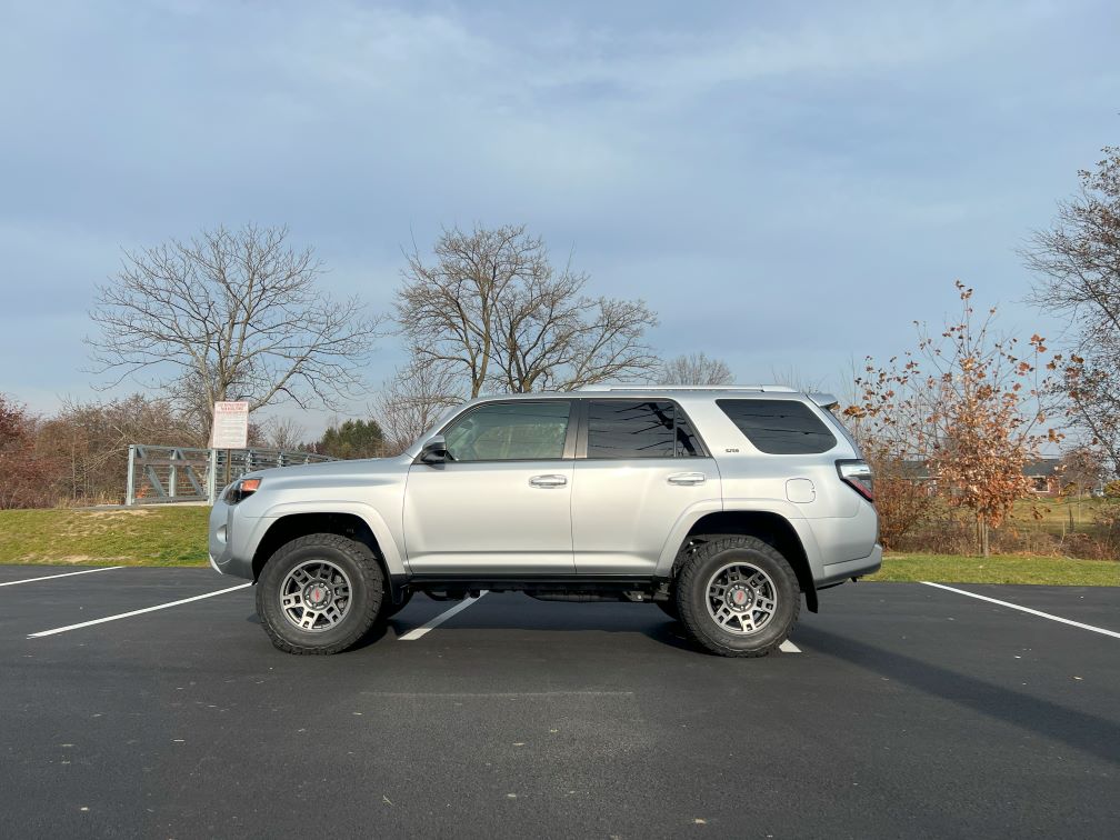

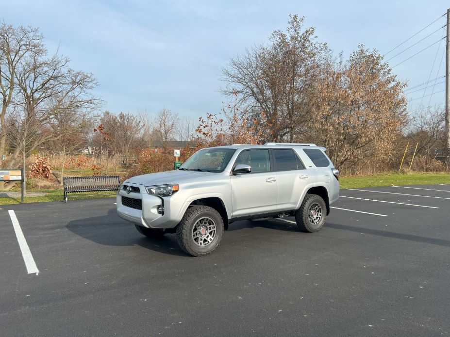

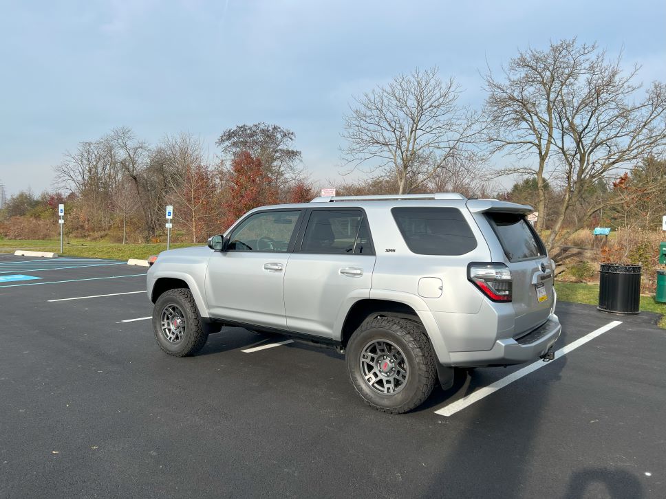

Finally got to doing my 5100 upgrade.
Used the 1.75" setting up front and a 0.75" Cornfed spacer in the rear.
Switched to Pro wheels and new tires. Tires are LT load range C General Grabber ATX 265/70/17 (would not have been my first choice but they were essentially new and came with the wheels when I bought them). Aligned, swapped TPMS, and balanced tires.
Quite happy with how it came out!

This looks perfect! Looking to do the same to my wife's 23 ORP soon. Thanks for posting pictures.
