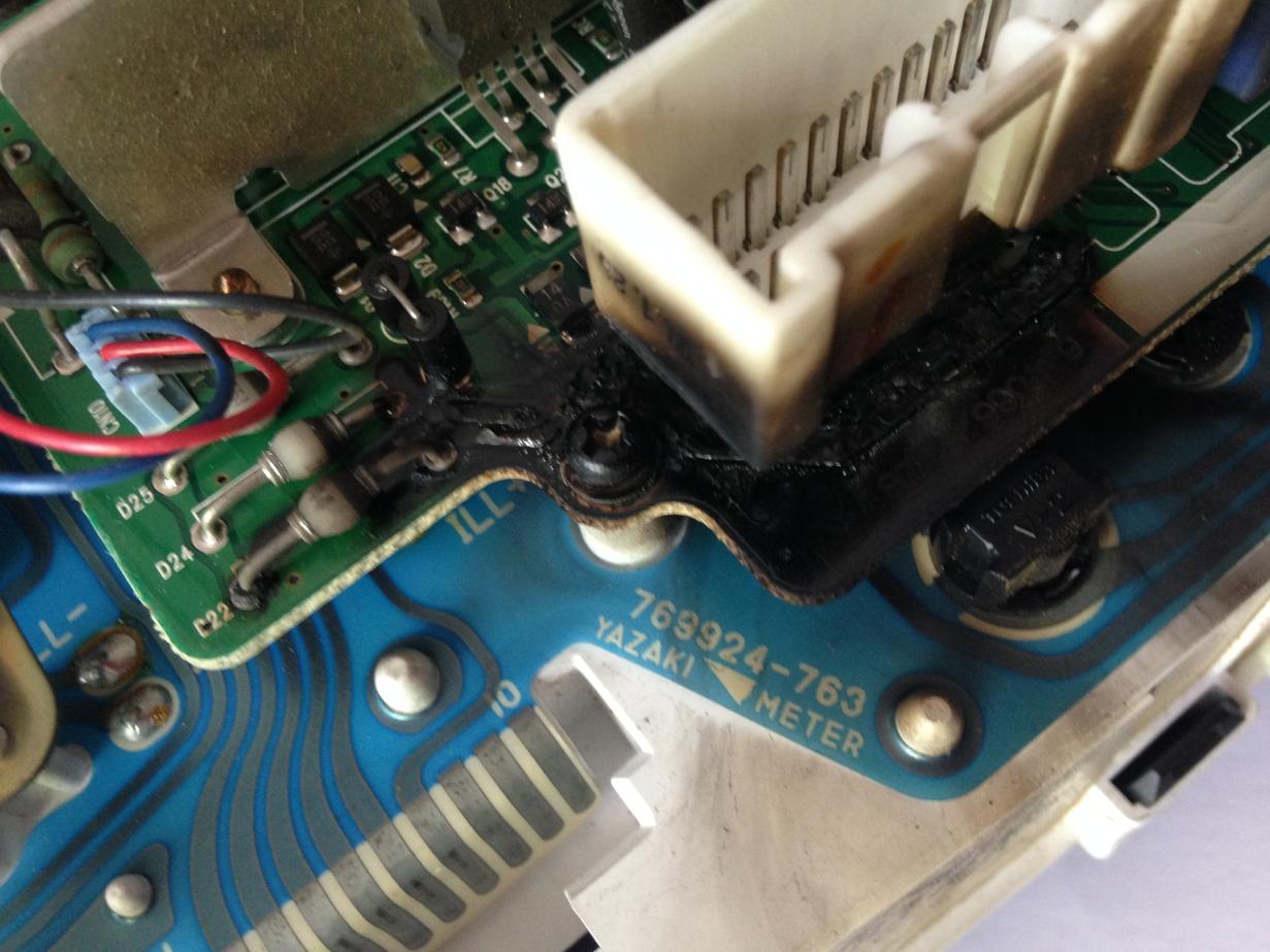

Ok so with the gauge cluster remove the door locks work perfectly fine; here is what I have discovered.
Yup, that can't be good. Certainly looks like something is shorting to ground. You can try delicate surgery with an Exacto knife to get the carbon off, without damaging the copper traces and achieving electrical separation between them. Odds of success are about 50/50. Problem is the cause of all this might be external to the CM, so any other issues in the circuit outside the CM need to be resolved.
Sounds fun, I like cheap/free fixes. Do I scrape the copper trace, or the green clean to soot, or both??

More important is the green. If the carbon comes off the trace, all the better, but leaving it is preferable to damaging the trace. Then you are SOL.

Looks like I may be getting the rebuilt and maybe a body ECU and call it done with SR5 seat tracks up front and fix the clock. Sell the good Limited seat parts on Ebay. Piece of cake.

Got the junkyard one for $100. Everything works like a charm.... The 4runner just went from 226k miles to 177k miles. :rofl:
The door locks now work, door ajar light is off, but I guess my CEL had broke itself because it's back on. :mad2:
