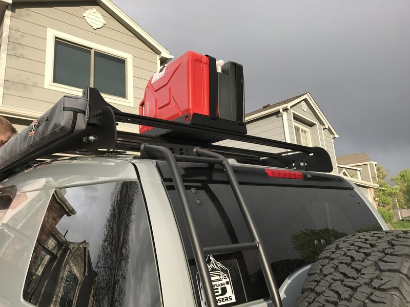

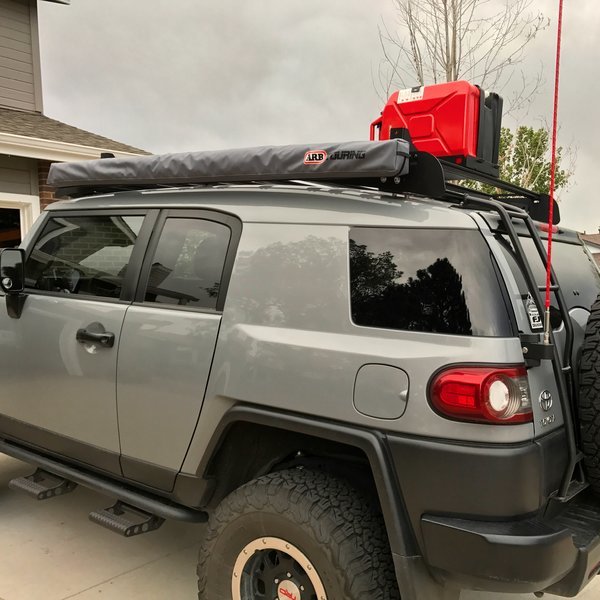

Finally installed the front runner dual jerry can mount and ARB awning.
For those wondering, the front runner jerry can mount does work with the rack. I had to adjust the spacing of the crossbars a bit and bought 1" 1/4 carriage bolts, washers and nylon nuts to make it work. Overall, I'm super happy with how it came out!
