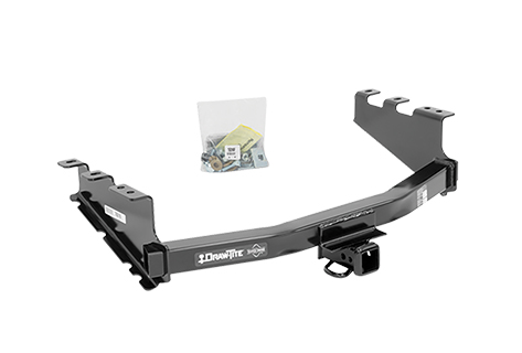

Not sure this should be used without a matching weight distributing receiver under a T4. The built in receiver is only mounted to a rear cross member, it does not have attachments going forward to the frame as in the photo. Not sure if one is available for a T4.
it's fine to use a WD hitch and this has been confirmed by another user with an email from toyotas engineer
i don't know why so many people think that toyota engineers can't do FEA or empirical testing when designing their hitch, it's bolted to the cross member because the cross member can handle the necessary forces
