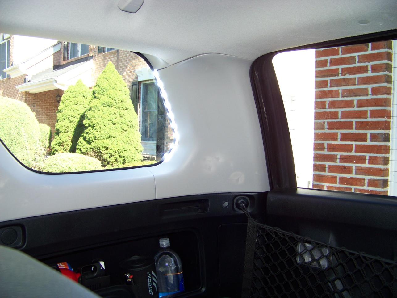

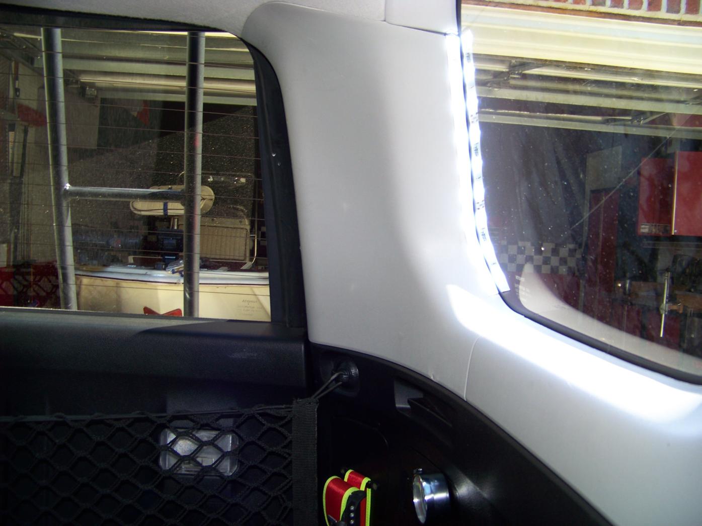

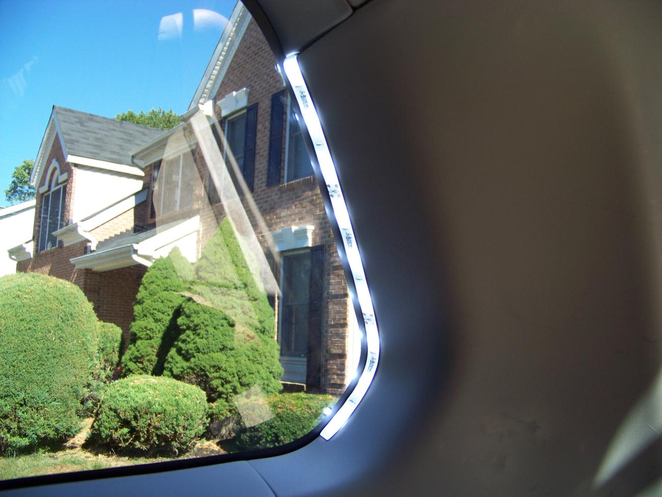

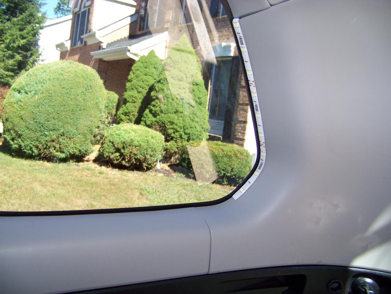

After my ride I decided to finally light up the cargo area (camping coming up!) with the Snooperstyle LED mod.
I mounted mine in a slightly different location. I figured they can't get ripped off by cargo where they are and you can't see them directly at all while looking into the cargo area (no glare). These are bright enough light up the area during the daylight, so I think I'll be alright tonight!:D

Nice placement of the LED strips. Very stealthy. Yup I occasionally knock it off when loading stuff, but usually I can just stick it right back on there. If I ever need to replace mine, I'd like to know your feedback on where you have them. Are there shadows in the corners etc?
Either way, you are gonna love this mod, especially for camping!
