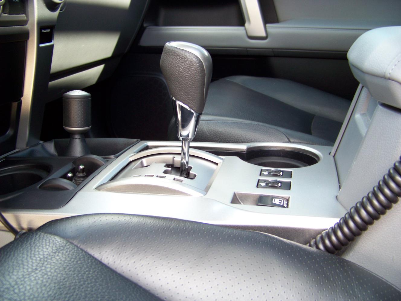

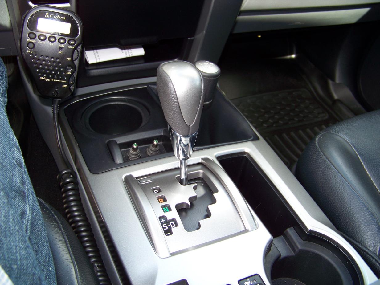

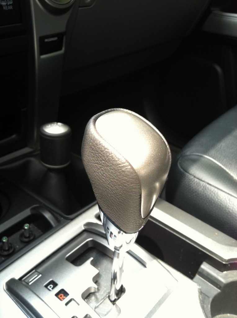

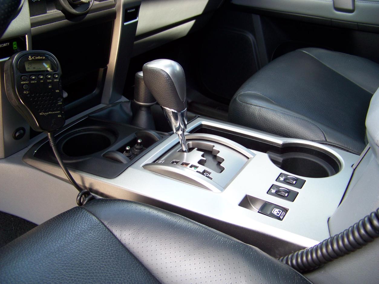

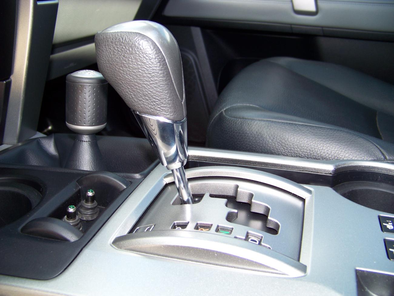

Lowered my Tacoma......
shift knob today.
I took a 5/16 bit and drilled the knob 1" deeper and took about 1/2" off the threads on the shaft. Now it's the perfect height, IMO. No more big-rig look!
This MOD also gained me 250 HP, FYI. :hand:
Anyways- here are some pics:
BEFORE:
AFTER:

how funny, another thread talks about aftermarket shift knobs and i find one that is blue for the warden's tacoma and i want to swap mine out also. never thought of taking her silver knob for my possible new 2014 LE.
thanks for the suggestion.

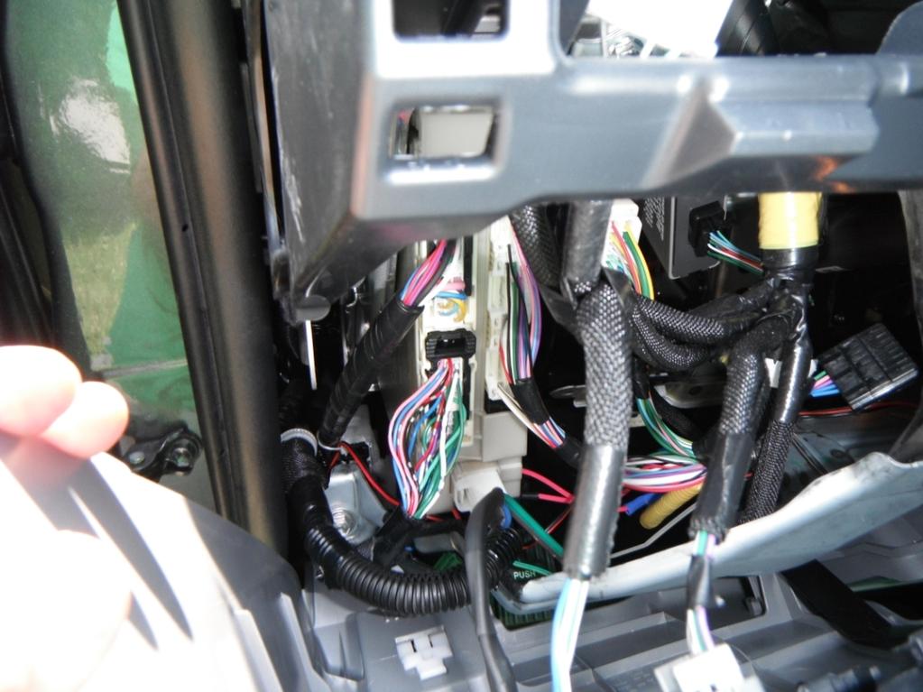

ANTMAN MOD #4
Independent Fog-Light Mod- using the factory switch.
This mod allows you to turn on your fog-lights whenever you choose. You can have the fogs on by themselves, with the DRL, with the Hi-Beams- whenever you want- as long as the ignition is on. If you want to be able to control the fogs anytime, regardless of ignition, the mod is even easier- but- you will probably leave your fogs on and come out to a dead battery. Your choice.
Others have performed this mod, but I don’t think anyone has done it with the original, stalk-mounted fog switch. I tried to cut as few wires as possible (only 2), so more people may be willing to take the plunge(?)
This is the location for the factory fog-light feed. PLUG 2D, PIN#9 from EWD
This is the wire- white with silver specs. This wire will “feed” the fog lamps.
