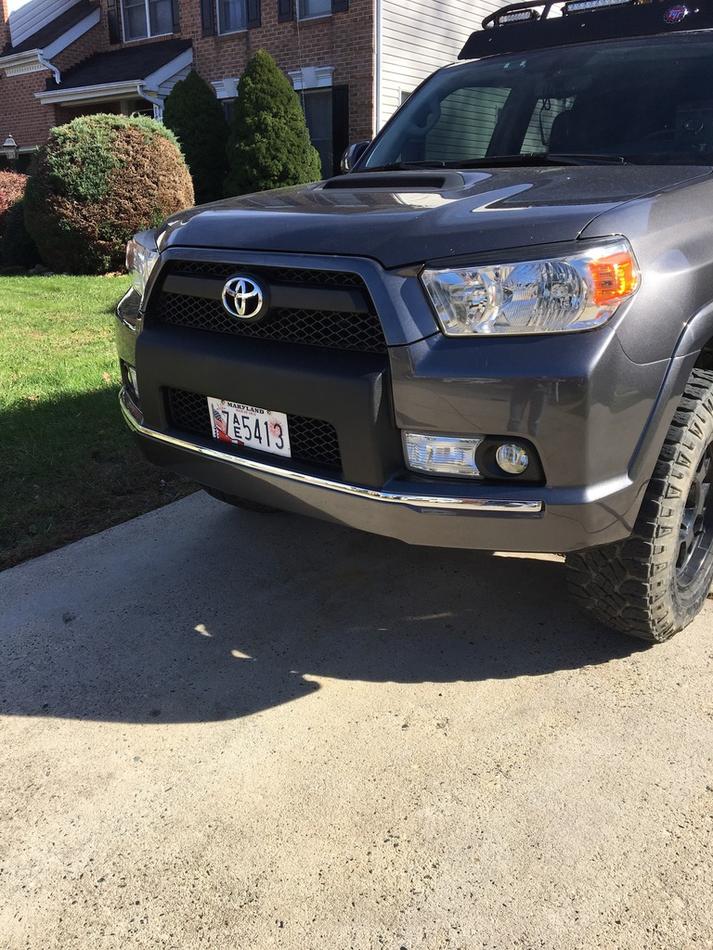

Check it out!
Thank you [MENTION=137555]Sleeter[/MENTION] for the bumper and [MENTION=112177]4RnR Grl[/MENTION] for the reverse lights!

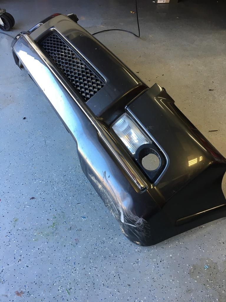

First the trashed old bumper, lol...

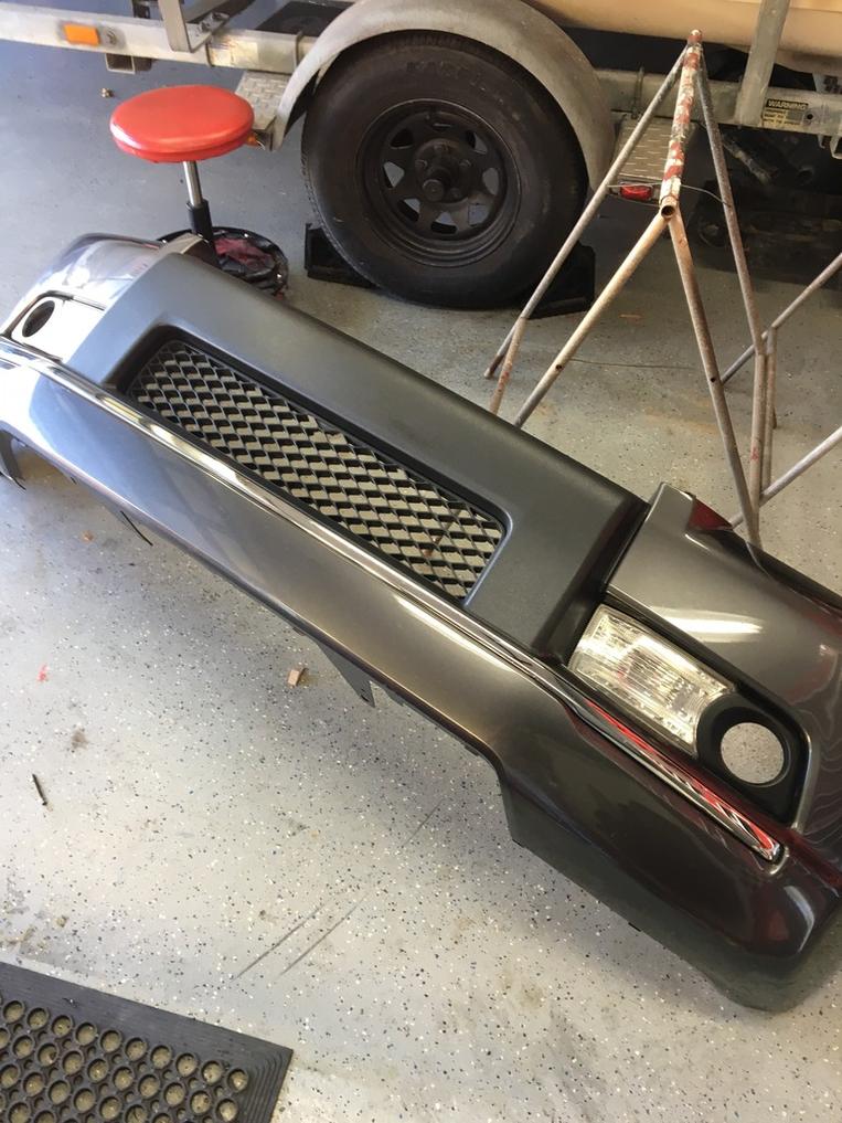

...and the new!
Gotta trim the liners to fit the newer bumper, and fab some new brackets too. These don't fit!
and........
I love it!!

...and the new!

Sweet job! That bumper should give you a few more inches of departure angle from the original bumper.

Thanks! There is a ton more clearance with this bumper!

Annnnd.... another semi-thrashed bumper bites the dust.
This replacement belonged to [MENTION=112177]4RnR Grl[/MENTION] and actually is in much better shape than mine. Thank you Corey!

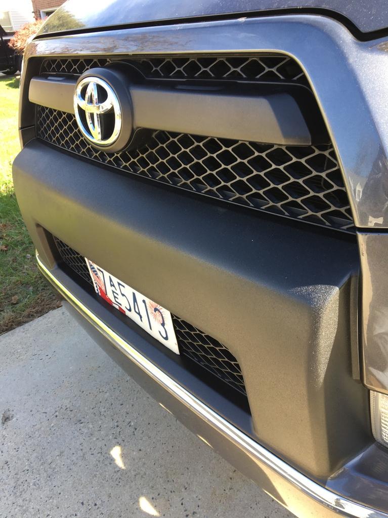

One problem- the bumper had 4 license plate holes in the front. :confused: I used a Bondo "bumper repair kit"- which is just flexible epoxy and some screen mesh. After some elbow grease, it worked out great- no more holes!
Rather than try to color match the gray, I masked the center and sprayed it with Rustoleum bedliner. I think it turned out great!

I painted the center black- the bumper was already gray.
