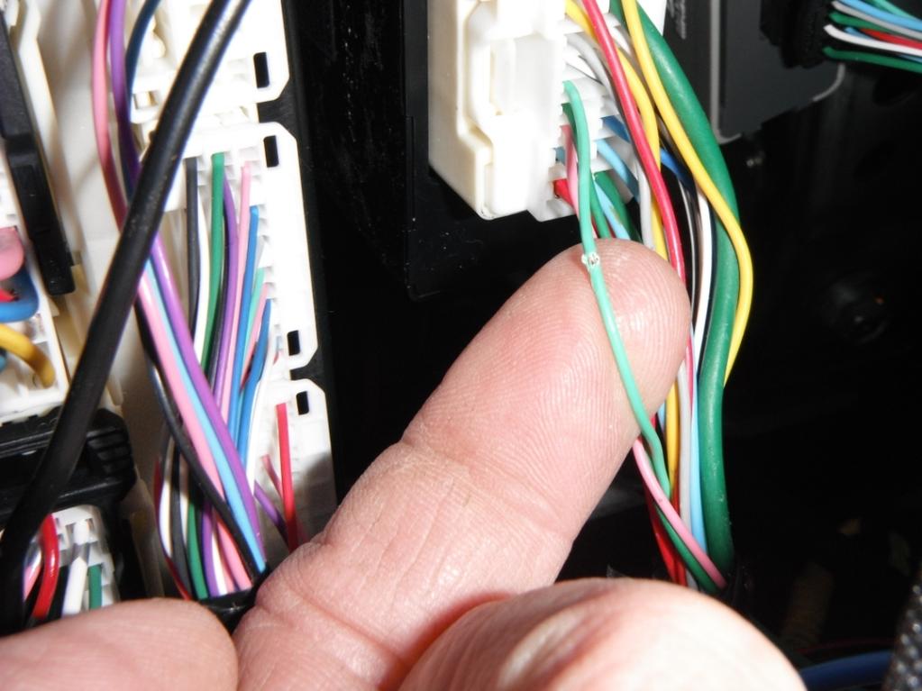

This is the wire you need to tap into and ground. Plug #F11-White, Pin #5. The wire color is light green.
Now would be the time to praise Nashman69g for posting the EWD...again! :)
Grab this panel and pull it towards you to access the plug - no tools needed.
Here is the wire. You can see the hole in mine from the test probe...
Use a pink 3M wire tap, or similar and tap into the wire to connect a wire lead for the ground.

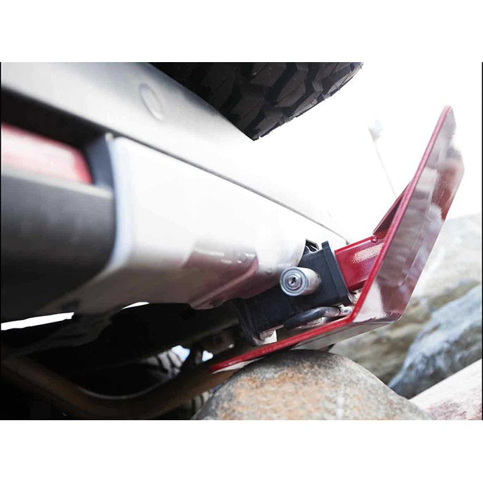

I made this today with hopes of preserving my new rear bumper while offroading. It seems that I have a habit of ripping it off, lol.
Nothing new here- plenty of companies make hitch sliders, but what's the fun in buying one? I had an old hitch in my junk drawer and some 1/4"plate steel (I pulled out of a dumpster years ago, lol) and my cheap Harbor Freight MIG welder, so...
The welds aren't that pretty but I think I got some pretty good penetration- I did jack the entire back of the truck up from the bottom of the skid and it held.
Ghetto points for this project too! I don't have anything stout enough to bend 1/4" steel. After some brainstorming, I barely scored the inside bend-line with a dremel and heated it up with a MAP torch. When it was ready I placed the plate between the concrete expansion joints in my driveway and sledge hammered the hell out of it. Hey, it actually worked! My neighbor was like, :wow:
Nice!
How do you keep ripping off your bumper?
Are you following Lane Meyers advice on off-road driving? ~~~ "Go that way, really fast. If something gets in your way, turn!"
This will also be pretty great if you ever get rear ended! :zoom:
