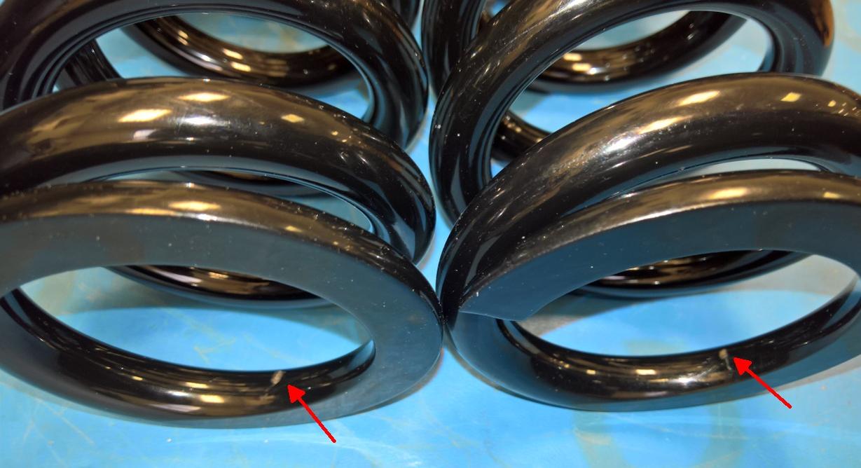

OK I carefully looked all over both coils and amazingly both have nicks at almost the exact same spot. My manufacturing experience tells me this got something to do with a careless worker at Bilstein rather than the reseller.
The nicks are tiny so I'll just dab them with something to cover the metal but it's still annoying.
hey , are you sure those are nicks, but rather center markers to where you should align them at? Its quite strange both are at the same areas to be considered a careless worker mishap if it looks intentional.
LOL that would be the equivalent of somebody leaving a note on your car by scratching it with a key on the paint. But in any case the coils have no alignment.
I've seen this before, I work in manufacturing. The same parts are manufactured using the same procedures and machinery so if at some point during the process a worker needs to be careful to avoid damaging the part and they are not, the damage would be similar across the same batch of parts.
Now that I think about it I've mostly had this problem with Chinese suppliers... they still have issues understanding quality control...
Obviously it is pissing you off.... As it would for me. Just call and make a comment, you never know what you can get out of it. Costs you nothing but a little time.
Must be since I am a lawyer by trade I have no problem getting on people's cases when I am not satisfied.
