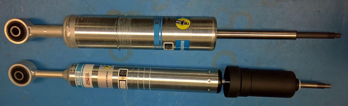

vs 5100
I did not realise the 6112s don't have protective boots... but I see there's very little space between the shock body and the coil so I guess that's why.
Sadly to assemble them I need to use spring compressors. Mine may be too large to fit on the coil so I might have to use the no-spring-compressor method.
Also sadly I found some nicks on the coils down to bare metal... I'll need to spray them with something or they'll rust quickly.

vs 5100
