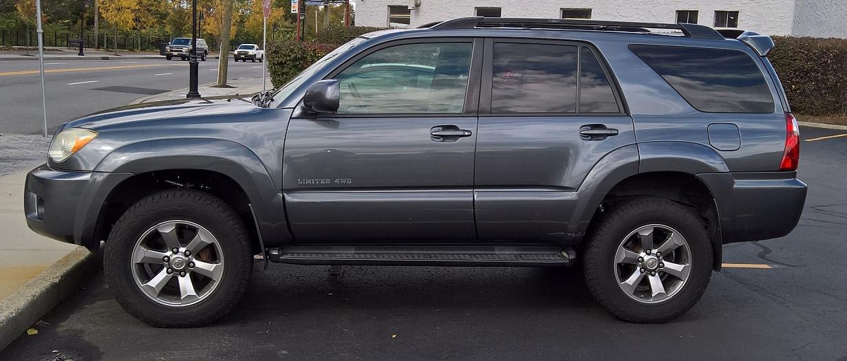

This is how mine is sitting right now. 6112's in the front set at the highest settings. Icon 2.0 w reservoirs in the rear and FJ cruiser springs. It's just slightly higher in the rear unloaded and perfect when I have gear on board.
