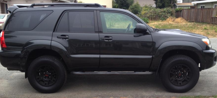

Picture of 6112's set at second clip— #1 is zero; #2 is supposedly .5
265/70/17 tires, so 1" taller than stock.
Nice wheels! Would you mind taking a few more from different angles of the entire truck? What about a measurement from the ground to the fender? I would greatly appreciate it!!

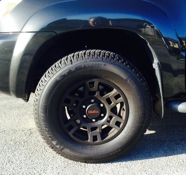

6112's set at second clip (1st=zero, 2nd =.5" according to Bilstein)
Level ground measurement from pavement to top of inside front fender= 36.0"
