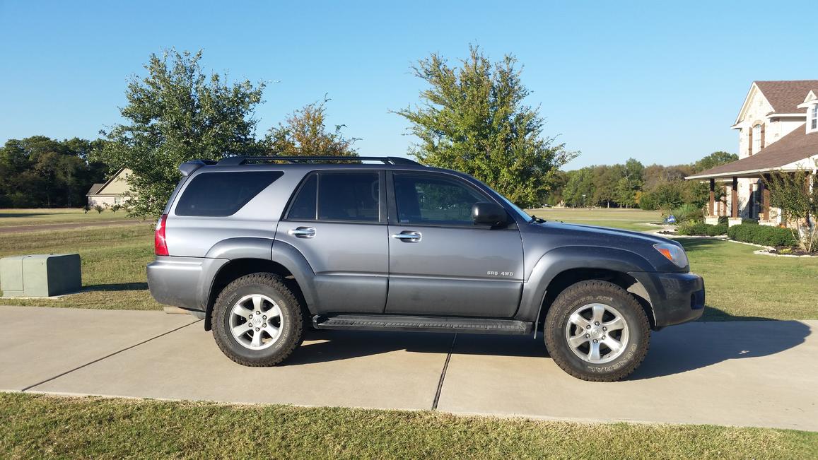

Could the 6112 be used at all with stock rear springs? It almost sounds like the first clip may provide a lift...
I'm thinking 6112 and 5100 rears for a nice almost level setup but not a crazy lift if the 6112's could be used to almost level the front.
At the moment I have Tacoma TRD OR front struts and rear shocks with stock rear springs. I love the way it sits but it's a bit softly sprung for my daily driving tastes. I spend more time towing than off-roading if I'm honest.

The bottom spring retainer compression provides the lift and the top of the shock requires a mount plate as well. So, there isn't anyway to just bolt them in on the rear. Bilstein recommends the 5160's for the rear. Although if you don't need the extra fluid capacity the 5100's would be fine as well.
Wasn't trying to use the 6112 in the rear. I'm wondering if these could be used in conjunction with stock rear springs to give an almost level look. 6112 in front and 5100 in rear with stock springs.
Ahh, I see. There should be no issue with using the 6112's to match the rear height & the 5100's will work as the rear shocks.
