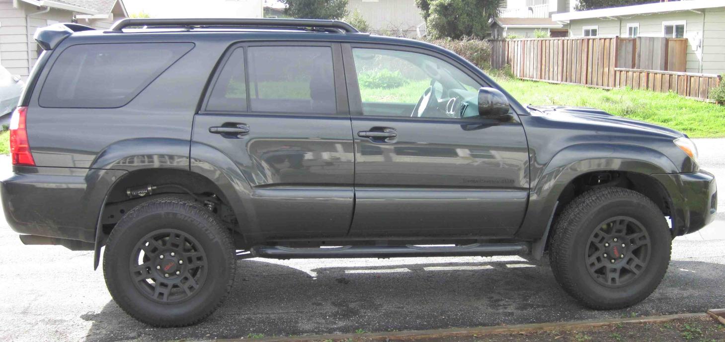

A couple folks have asked for images and info.
'06 Sport, 4wd, 6 cyl., 98k miles, 265/70/17
Front suspension: Bilstein 6112's
These have four notches. Mine are set one notch up from zero.
Rear suspension: Icon 2.0 remote resi's with 2" Icon springs
Stock UCA's
The 6112's have great on-road manners— smooth but firm, absorbing everything you can throw at them. Went from functioning XREAS (swishy), to 5100's (too harsh), to 6112's. Originally open to Icon front C/O's, but 6112's proved to be excellent. Only off-roading has been fire roads and snowy trails.
Hope that helps.

looks great man!! did you by chance get to measure how much lift you got in front?? looks like ~1-1.5"
good deal- im gonna be putting these on by springtime and looking for 1.5-2.5" in the front to go along with 1.5" rear lift w 5160's...so its gonna be either yoursetting or the next one up
are you gonna keep the 6112's where thry are at or are you considering going up one notch?? i think it looks good now but the rear is tall enough if you did want to go up..either way i bet it rides awesome

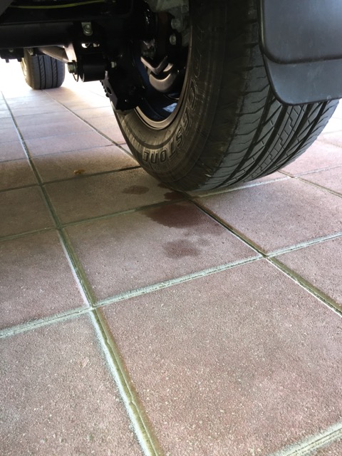

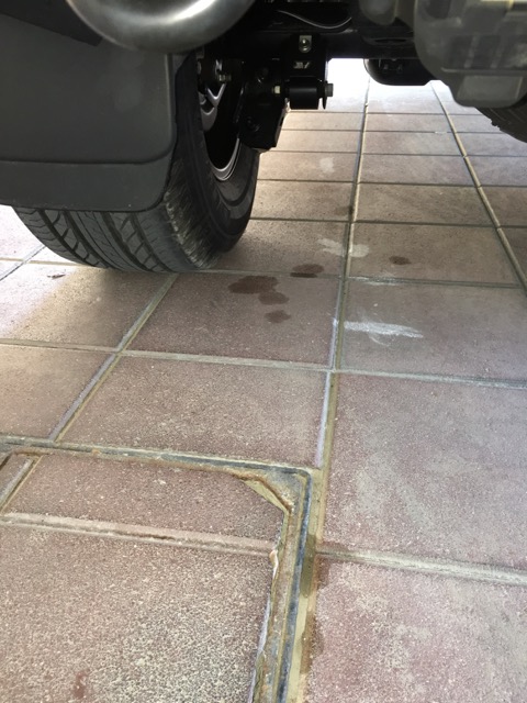

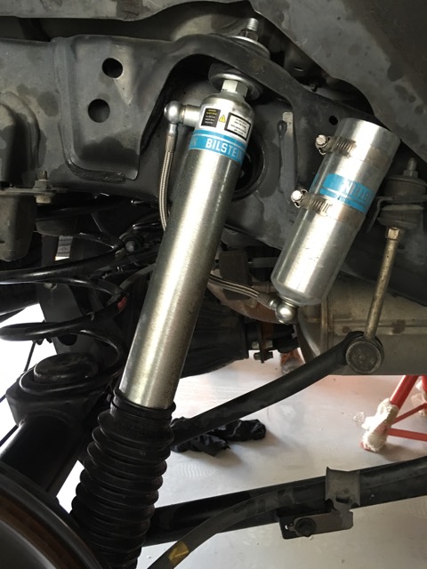

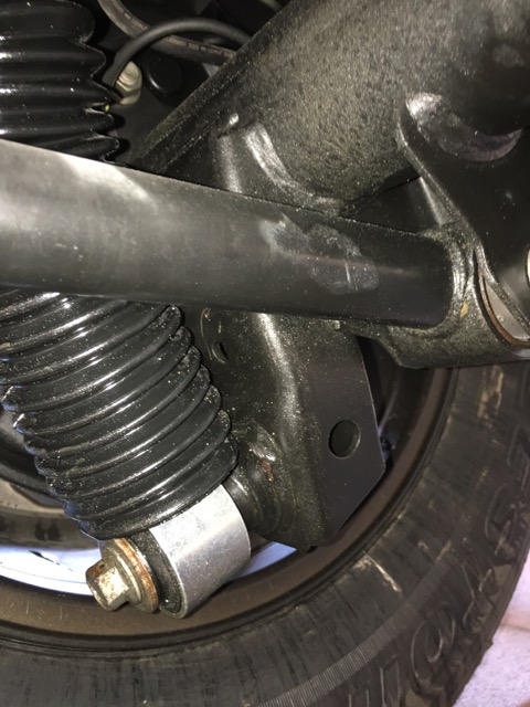

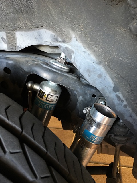

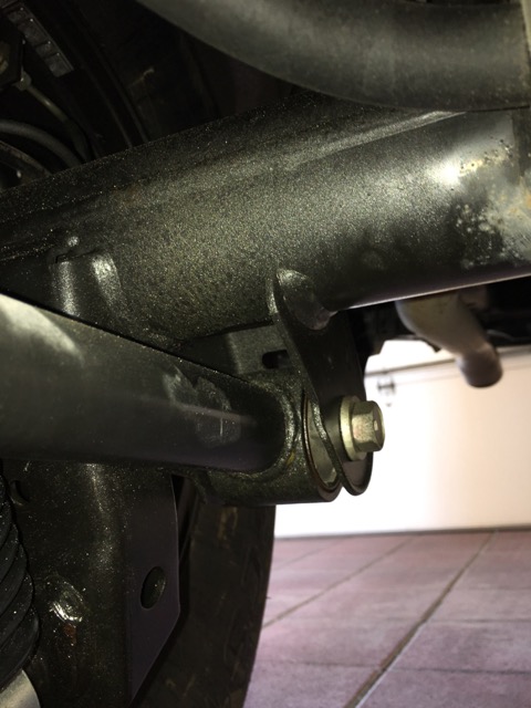

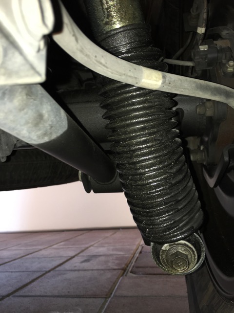

Sorry guys first time poster here on this lively community of enthusiasts. I'm a Canadian living in Dubai (don't rush to judge please) and I have a 2015 TE.
I was encouraged by what I've read here about the Bilstein shocks/ lift and I wanted to give my rig a better stance, so I ordered the 6112's (DON'T ASK ABOUT THE SHIPPING COST) and 5160s.
Got the front really quick and I installed them right away and was very happy with the setup but waiting to lift the rear as well, as I wanted to lift the whole vehicle about 2".
The rears were, ordered from Total Automotive, arrived and they were in better packaging than the fronts which was a good sign, installed professionally here in Dubai with stock springs as I did not land on lift option yet. Sway away 1.5 was my choice but the shipping cost was double the price of the springs.
cut the story short, vehicle was level fronts set to 3rd notch, Mrs taking the kids to schools every day and .......5 or 6 days later the rears are busted as in no damping effect what so ever and the rear end was allover the road with my wife and kids in it :mad:

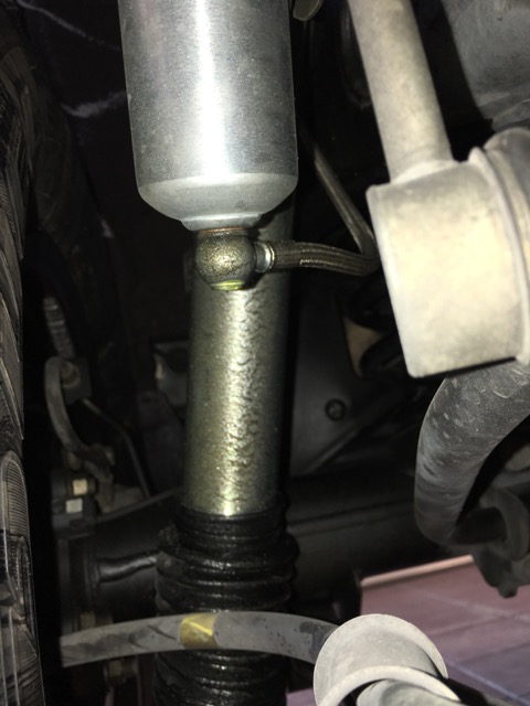

I noticed traces of oil on the garage floor and realized the rear suspension was covered with oil. The shocks lost the gas and most of the oil in those few days which was hard to believe given Bistein reliability and warranty. went today and took them off and put the stock shocks back in so we can use the truck. I noticed that most of the oil was coming out of the hose connection on the shock body and later realized that it was not tightened the guys who did the install never touched it and the installation instructions never mentioned anything about checking them or tightening them as part of the install procedure did anyone experience this (I very much doubt it) this is suppose to be torqued to spec in the factory to avoid damaging the seals unless it was produced early Monday or late Friday???
I sent an email to Total Automotive with a lot of pictures and waiting for their reply I hope they will come through with the replacement the only wrinkle is that I cannot ship the leaky shocks back to the vendor no courier service will accept them not when shipping internationally.
Guys check the shocks before you install them I don't this to happen to anyone, quite frustrating. I paid $150 to ship the rears alone and I'm not willing to ship them back for another $150
Total Automotive over to you guys please help
