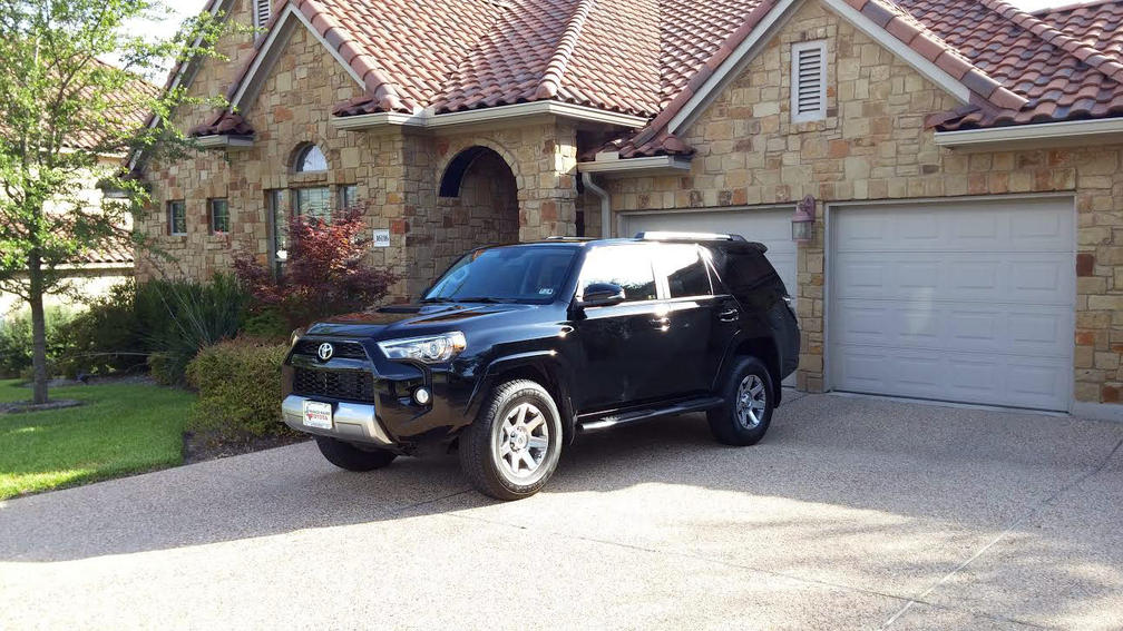

Hey guys,
Just curious if anyone has powder coated a set of 2014 Trail Edition wheels yet?
Planning on having it done to my wife's new TE.
Would love to see some pics :)
Had the Range Rover Supercharged wheels that the TE is replacing power coated and loved the look.
Thanks!
