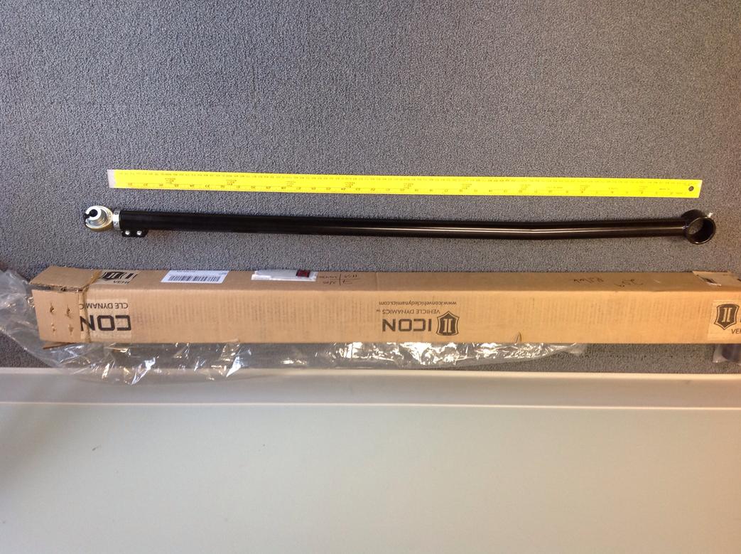

Loosen the two pinch bolts and turn the hex-shaped adjustment collar next to the spherical rod (heim) end to lengthen or shorten. The other end is fixed with a bushing and obviously does not contribute to the adjustment process. EDIT: I just got one of these in the mail the other day, I could take it out of the box and make a short vid if you like.

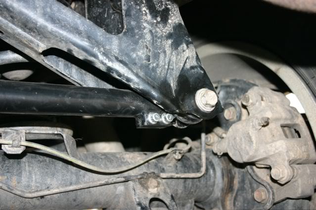

Any info would be great. I'm trying to understand if it would actually be adjustable on the truck. Pic below makes me thing not so much.

I'm pretty sure that's the frame mounting pocket pictured above, which would mean that the track bar is mounted backwards. The heim end is supposed to be installed in to the axle mounting pocket as per the instructions, and the numerous pictures I've seen of these things mounted on FJ's and 4Runners.

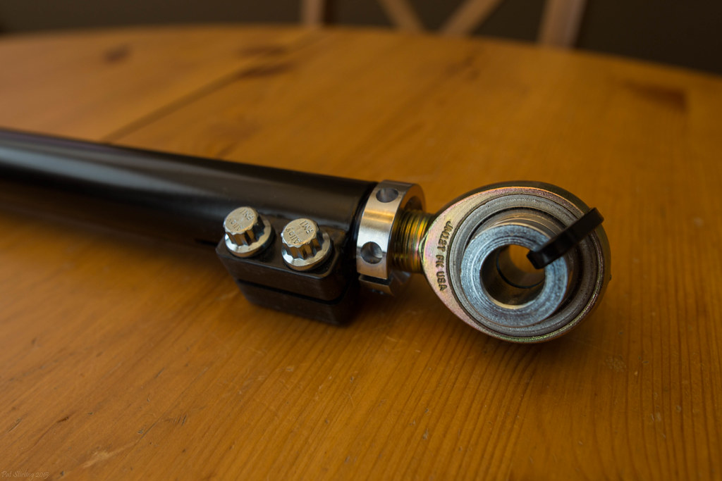

Here's a picture of mine so you can see the adjustment mechanism:
You'll need a 3/8" torx socket to loosen the pinch bolts, then some sort of peg or an allen key to make the adjustment to the threaded collar. They also recommend to make equal adjustments to the rod end and the adjuster to avoid backing either one out to far and not having proper thread engagement. Based on the amount of threads I'm seeing, I'm guessing there's ~1.5"of safe adjustment on this thing. 2" max.
So main question: Is the adjustment collar accessible when Installed.
If you install it properly, yes. Looks quite easy actually.

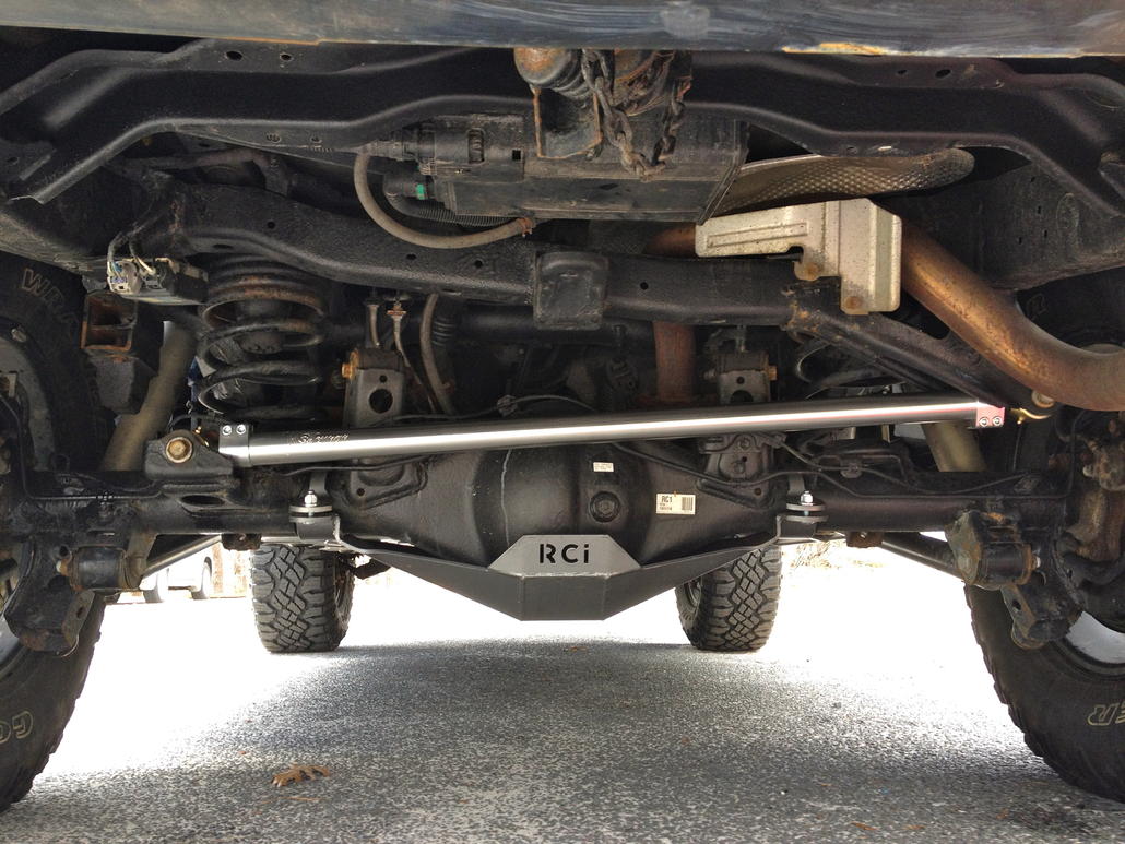

I run a Rokmen.
That thing is sweet! I'm almost having buyers remorse.
Everything stated here is correct. I just installed mine this past Sunday, super easy install and can quickly be adjusted and put on without a lift. I used a Allen key to make my adjustments to the collar. I did use ratchet straps and blocked my tires so nothing would move but I think it was pointless.
That's not an External Torx bolt head, those are 12-Point bolt heads.

This bar is actually installed incorrectly per icon the pinch bolts are at the axle and facing up , I just installed this on my 2015 and called icon to confirm. The urethane pushing with the grease fitting goes at the frame the pinch bolt is at the axle and facing up. Call icon
Do yourself a favor and get a Rokmen.
It looks nice, but not adjustable on the truck. Also, the ones with the jam nuts seem like they would be hard to adjust on the truck, since the jam nut might be hard to get at on the frame side mount. Also looks lke the rod would not spin because of the colloars, but I might be missing something.
Thanks for the pic of the correctly installed ICON bar. The one I first came across just showed it installed backwards.

Heh.. right you are. I guess that's why it says nothing about torx bolts in the instructions, eh?.

I can promise you you will hate that icon bar when you have to replace the heim ends EVERY year because they squeak. As well, the heims will transmit FAR more NHV in to the cab than a Johnny joint will
And I might be wrong, but Rokmen designed the bar to be adjustable on the vehicle via reverse thread joints. I'm 95% sure (recalling from memory, I'll have to look here in a little bit) that there is a machined square section in the middle of the bar for a open ended box wrench to extend or collapse the whole thing when the jam nuts are loosened.
