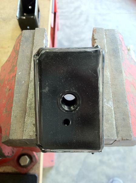

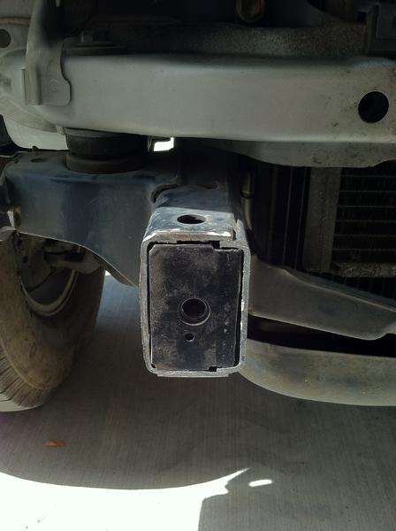

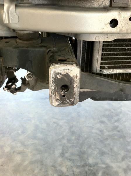

I did mine a couple months ago and it came with 'end caps' that are actually extensions for the Tacoma. I just cut off the 'end' portion of the block and welded it onto my frame rails, and the nut for mounting is right in place.
You can see my cut lines....
drdolittlerwc-albums-arb+install-picture21165-arb-extension-box-sent-tacoma-fitment-where-cut.jpg
Pre-weld...
Post-weld...
drdolittlerwc-albums-arb+install-picture21167-welded-ground-boxed-end-before-paint.jpg
Pre-weld...
Post-weld...
The blocks that you used are actually part of the install kit for the ARB bumper? We have not opened the box that came with the bumper, yet. It is sitting on the shop floor at the body shop

Yes that frame rail extension/cap that he used comes with the bumper kit. If you look through my build thread, you will see it in the pictures where I laid all the parts out
