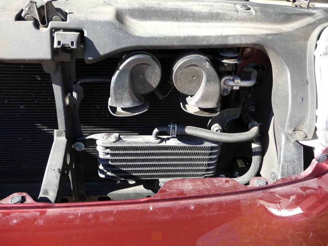

A few notes... using the output from the top of the transmission cooler (on my 2006 V8 SR5 4WD anyway) was easier than what is shown in the original post. You don't have to remove the front skid plate - just pop open the hood and disconnect the line on top of the cooler. In the photo below, it's just below the middle of the 2 horns:
