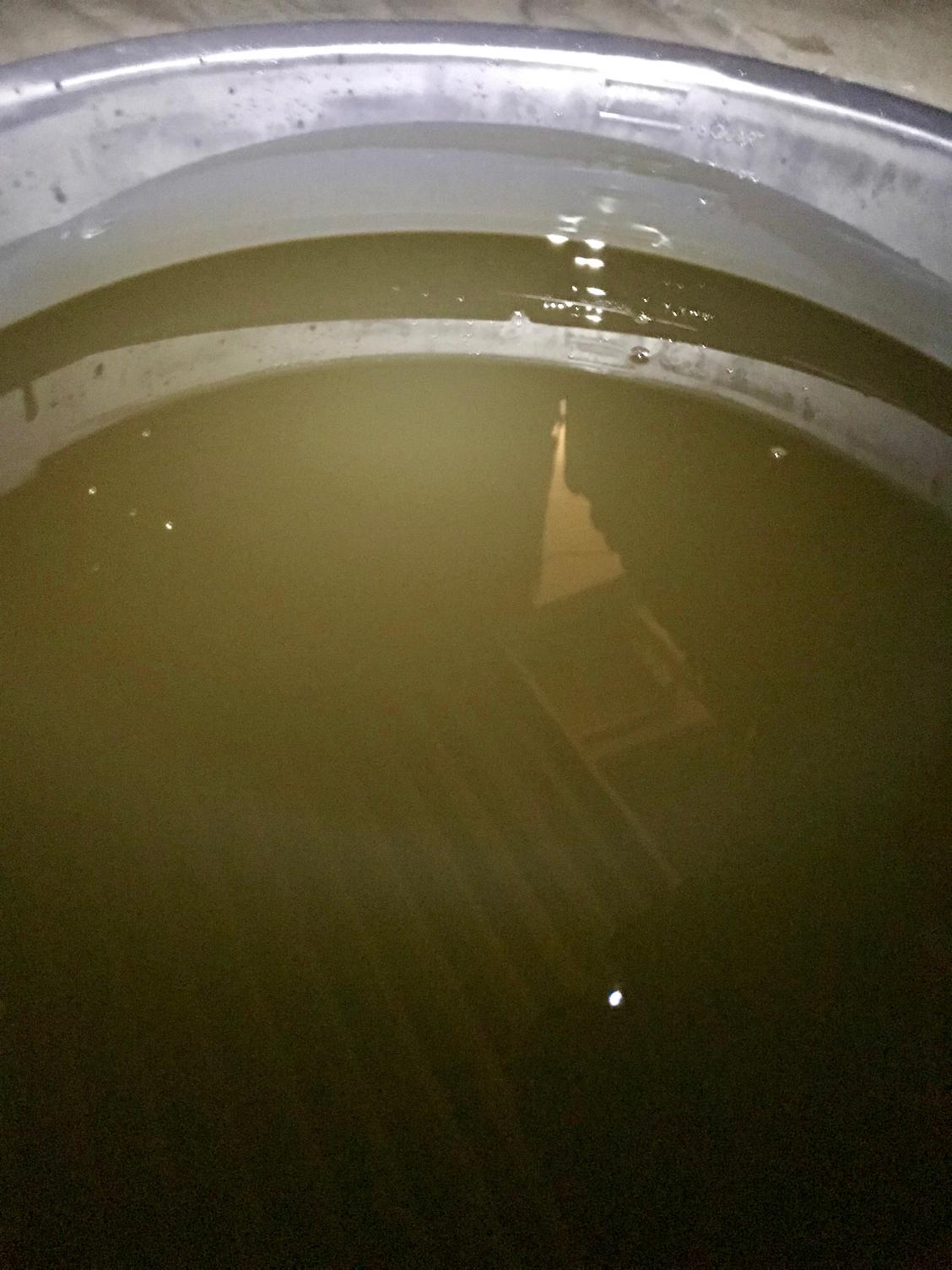

Also for anyone wondering - I attached a picture of my old ATF so you can see what 148,000-mile Toyota WS looks like.
97E
