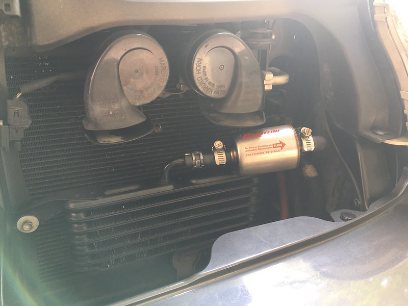

I have a 2006 V8 and the fluid path through the radiator is upward. Tried it the other way and ATF hit the fan. The tranny pump works like a check valve and no fluid can be forced the other direction. It just goes everywhere when the hoses blow apart. The time to change fluid would have been cut in half if I had the flow direction correct.

Edit: Accidentally removed the original picture that shows filling the transmission from the transmission radiator. Here's another pic showing the flow direction from the radiator to the tranny.
You could gravity feed as long as you feed it in the right direction, but it will take longer. Pump was fairly quick. Easier to make a connection to the 3/8" tubing too.
Running the engine won't pull fluid towards the tranny when its opened up at the radiator.
This should make it clear:
