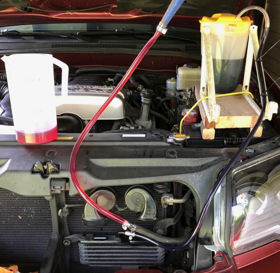

Swapped out the transmission fluid today via the trans cooler lines, took a couple hours going slow but steady. The new fluid drains back into the tranny fairly fast when it's hot out, not sure why some are against that method. I performed 7 two quart swaps total till new clean fluid was coming out using my custom pitcher holder by the battery. Plan on installing a Magnefine 3/8" Magnetic Inline Transmission/Power Steering Filter next time I place an Amazon order.

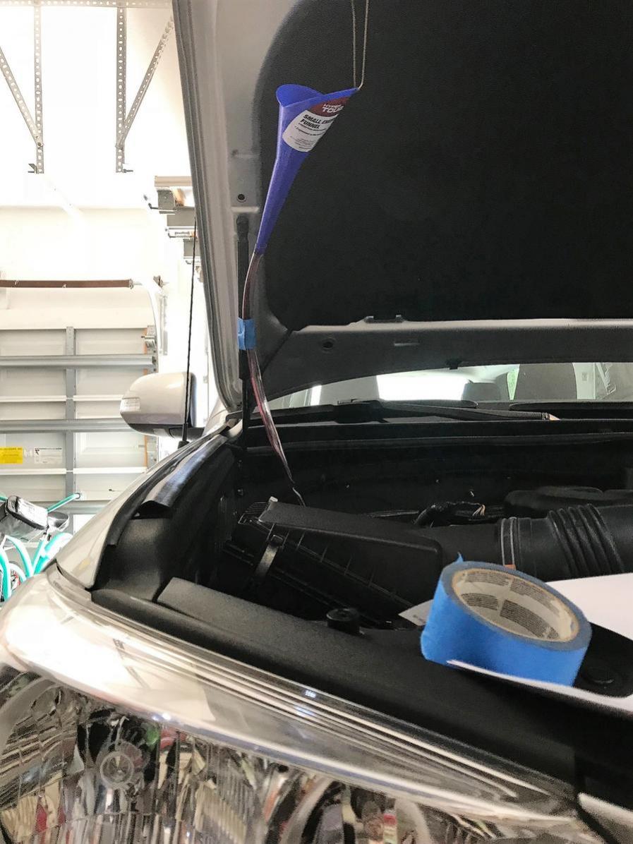

crawling around the underside of a vehicle with a hand pump makes no sense when it's so much easier to fill from above with a length of clear vinyl tubing and a funnel. Let gravity do the work.

yes the fill hole is the best way to fill fluid on these trans, its what its designed for, people who mess with using the trans cooler line or hand pumps are just making things harder than they need to be. look at the pic posted by lester lugnut, that is exactly how to do it using a funnel & let gravity do the work... except i suggest to use as big of a funnel as you can fit in the end of the 3/8 tube, it will add 2 qts in 2-3 minutes.
thank you for posting that pic, that is exactly how i did it but i had a helper hold the funnel for me above the fender while i filled it. easiest way there is to do this aside from conjuring up an elect pump that has been mentioned on other threads.
That's how I did mine last year, even looks like the same size funnel, also blue lol
