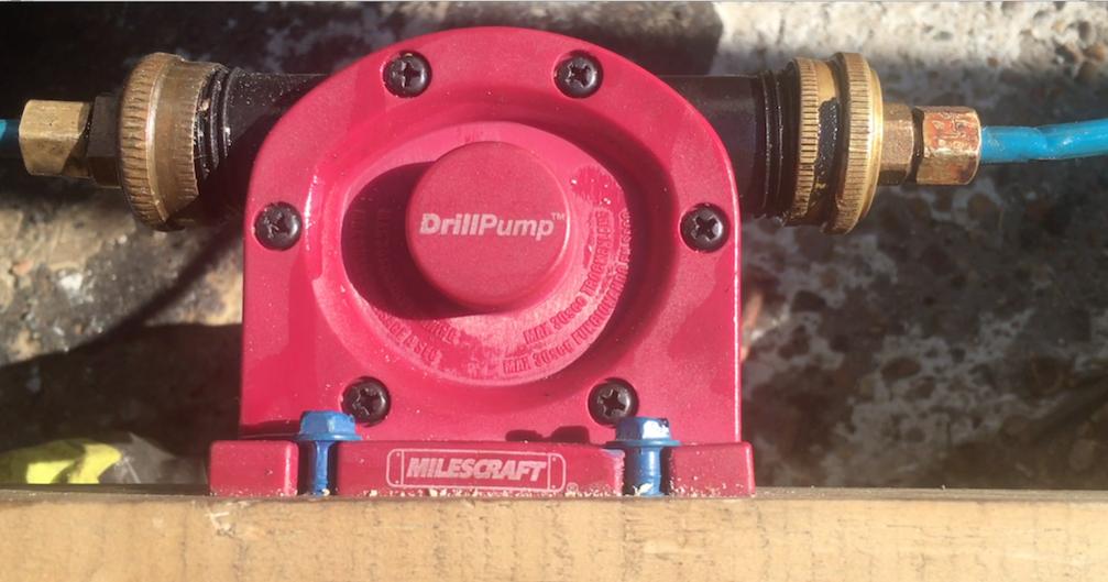

How to use a drill pump to fill the transmission - w/ Pics & video
I used a universal electric fuel pump and it did work pretty good and was simple. You could also use a cheap drill powered plumbers pump.
I used a drill powered pump. It worked extremely well, and saved me a lot of time.
Here's what I used and how I set it up:
I bought a Milescraft Inc. 1314 Drill Pump 750 from Amazon for $12.99.
and used four long screws to secure it to a 1x4 piece of wood about 4 feet long, so that I could run the pump with a drill,
and not have to keep the pump from spinning.

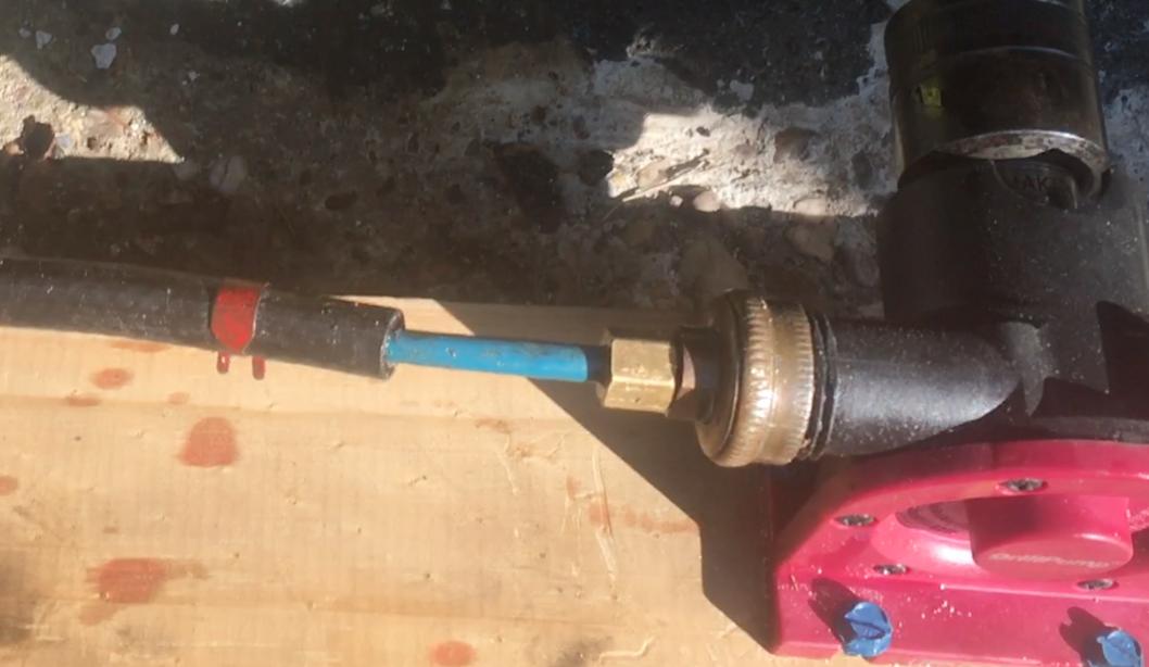

At home Depot I bought 2 garden hose to 1/4" compression adapters.
Then I used two pieces of 1/4 tubing. I ran one piece (about 6 feet long) to the fill hole on the transmission (after I removed the plug).
Having it this long made it easy to position the hose so that it would stay, while I could sit next to the truck as I worked.
The other piece of 1/4 hose I cut to about 8 inches long and put a longer piece (about 4' long) of 3/8" transmission hose over it and secured it with a clamp.
The 3/8" hose was needed to help the pump pick up enough fluid. I first tried using a longer piece 1/4" hose on pick up side, but the pump struggled.
There was just too much resistance from the long, small input hose.

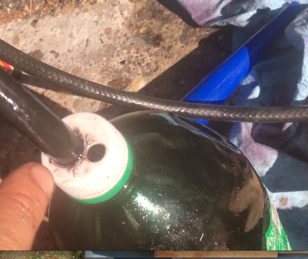

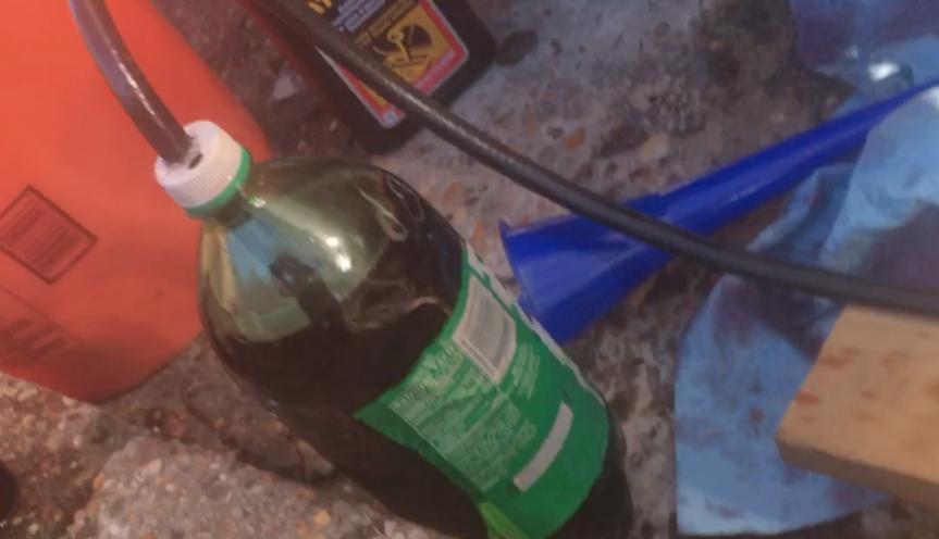

Lastly, I cleaned, dried and then used a 2 liter bottle to hold the fresh fluid.
Use a funnel to make it easier to fill the 2 liter bottle.
I drilled two holes in the cap of the bottle.
One was sized so that the 3/8" hose could go through it, but make a tight fit. Push the hose in far enough so that it reaches the bottom of the 2 liter bottle,
this way it can easily pick up fluid when you run the pump.
I drilled a second vent hole about 1/4" in size.
The vent hole is needed so that air can enter the bottle
as you pump fluid out of it.

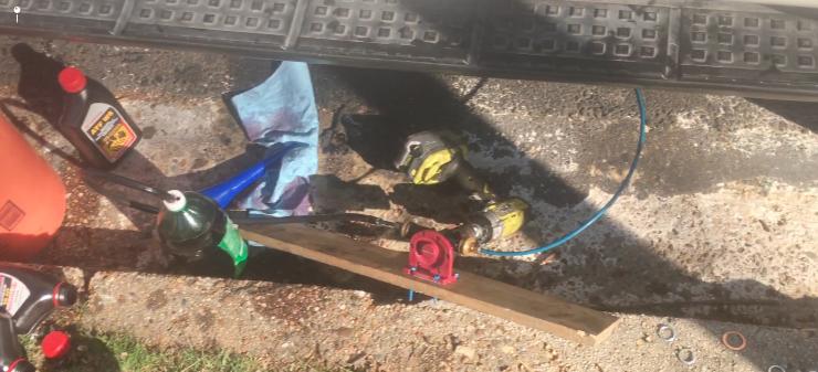

Adding a drill to the pump (or in my case, a bit driver... it's what I had handy),
and I was good to go!
The whole setup made it easier for me to hold the fill hose in place while running the pump without having the pump spin,
and without having the new transmission fluid bottle tip over and spill.
I put the board flat on the ground, and that was enough to keep the pump from moving.
I was able to pump 2 quarts of fluid into the transmission
in just under 2 minutes! (see youtube video)
, which saved me time over hand pumping,
given that I pumped a total of about 12 or 13 quarts during the whole process.
I hope this is helpful to someone doing this fluid replacement method.
