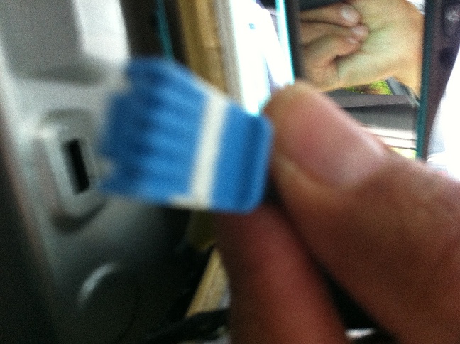

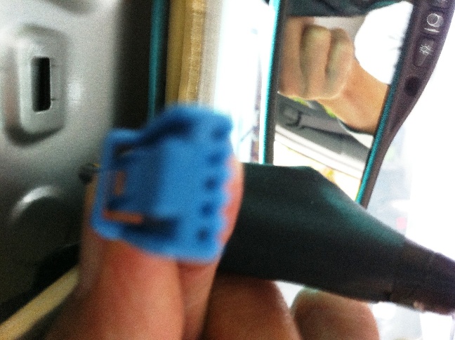

So I was able to get a used Auto dimming mirror w/ compass originally from a corolla for my used 2008 4-runner..
I was about to follow the instruction when I open the moonroof/sunroof control and to my surprise I found a 5-pin blue connector wrap up together with the connector of the sunroof console harness.
Now I am wondering if that is connector for the rear view mirror?
Any feedback will be appreciated.
Thanks in advance.
