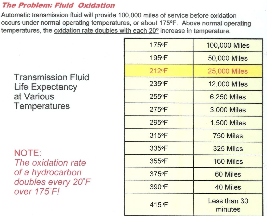

I agree with Natemob. I tow alot, and routinely climb steep mountain roads. I bypassed the rad cooler and installed a B+M cooler and trans. temp. gauge. I ran this setup for a year before my engine replacement. Towing on steep hills, I hit 200-210 routinely. During a particularly steep climb behind Whistler BC, I hit 220. I was concerned with this, so when I did my replacement, I installed a second cooler with a thermo-bypass. This Summer the hottest I observed was barely 200, but generally, temps hovered 160-180. Ideal operating temp. is 160. On the few cool days we've had recently, and during light driving, its barely hit 120. Too low a temp isnt a great thing either, so I'll probably block out one cooler this Fall. On other threads here, I've seen a graph showing Temp vs fluid life (viscosity breakdown). Basically, fluid life falls rapidly beyond 200 and at 240 its cooked. Once the fluid breaks down, transmission components breakdown. Synthetic fluid has a higher breakdown temp. which is what I'm running.

General relationship between trans temp and fluid life attached.....
