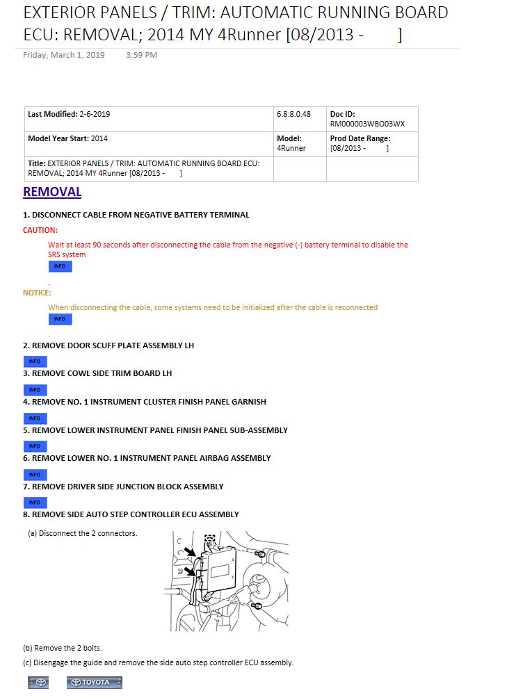

If you do want to remove them I've attached the instructions.

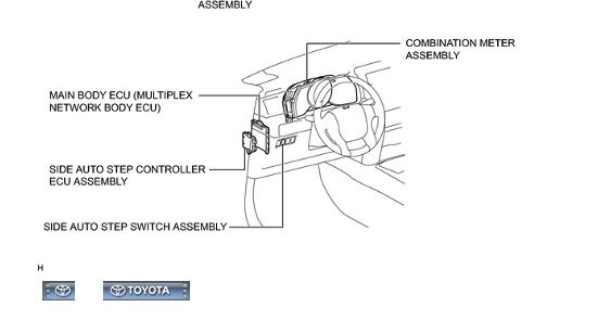

It looks like I will need to replace the ECU to resolve my issue ( https://www.toyota-4runner.org/3331155-post47.html) and I'm looking for any info about location of the ECU, auto boards/step disassembly...?

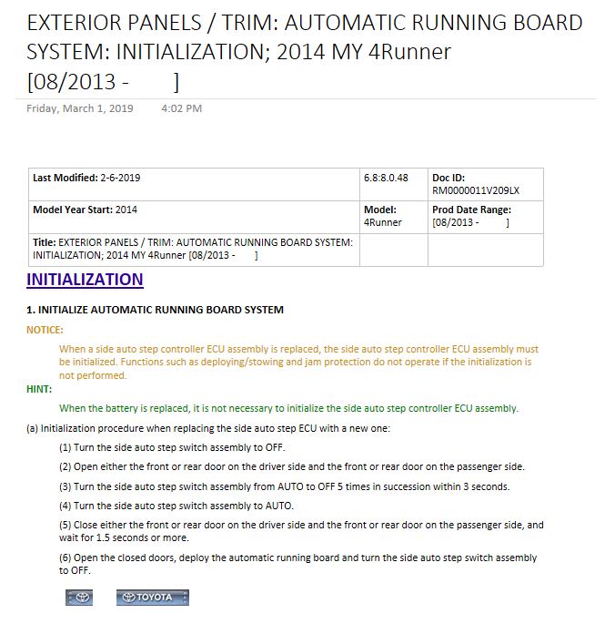

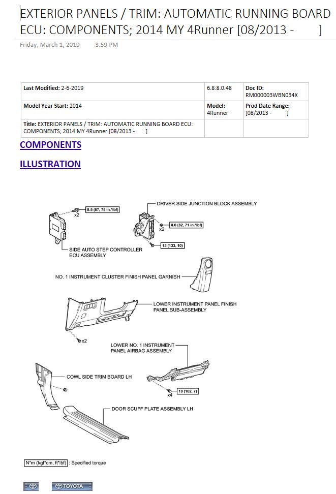

I uploaded Jpeg images, does that help?
