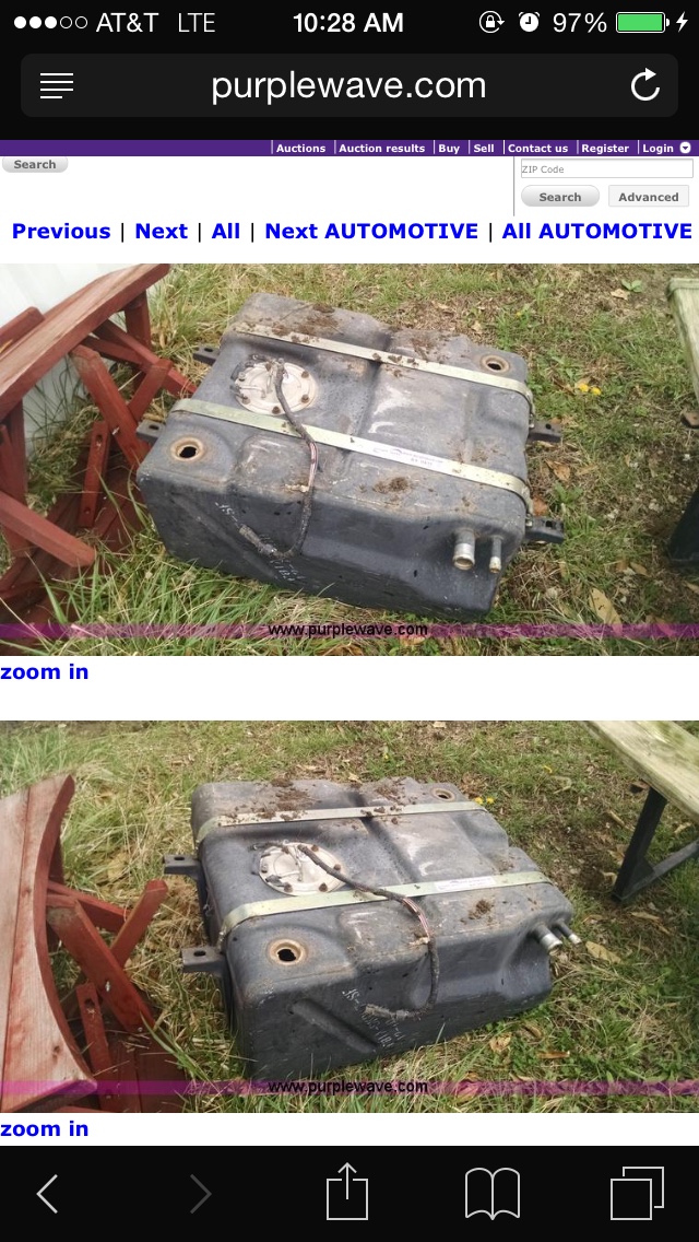

So online by me right now has an 2000 f350 tank I'm looking at seeing how big it is. Probably damn huge but we will see.
Edit. 31x29x15 is about the same size as the spare tire.

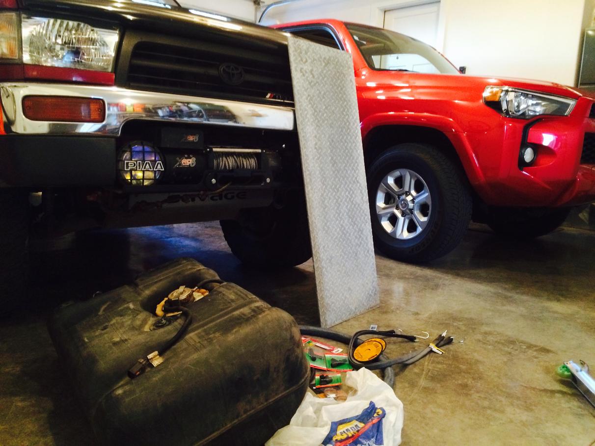

I'll tease this a bit. 20 gallon tank with sending unit out of a Cherokee, 68 lbs of steel plate, bunch 'o tubing, marine gas fill neck. Hmmmm....
Don't worry more pics to come. 38 gallons total!

OK - the marine grade filler neck I needed just came in. Tonight I have to cut our the cross-member that holds the spare tire for clearance. I'm trying to figure out if I need to weld a new tubular cross-member in a different place or if I can rely on the huge piece of plate steel that will act as my skid to stabilize the frame. I'm leaning towards the plate since the tow package also acts as support.
I'll get pics of the process throughout this weekend.
