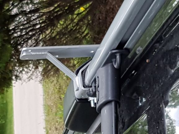

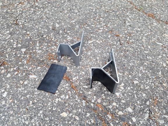

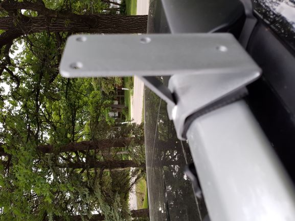

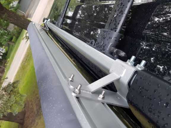

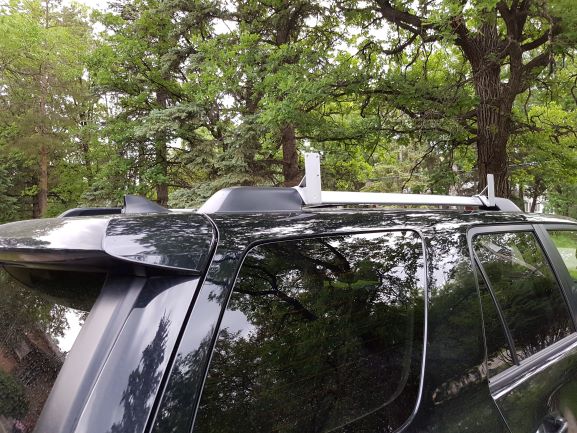

Spent a little time measuring up the profiles of the roof rails and came up with this design for an awning bracket. Then had my local sheet metal shop laser cut, bend and weld. They offered to powder coat, but I needed them for my trip to Moab this past June, so I primed and painted them. Used rubber sheet to protect the rail finish. 3 weeks of overlanding in Utah and Colorado and a summer of overlanding weekends back home and they held up fine. If I did it again, I'd get them powder coated, paint scratched where the nuts came into contact.

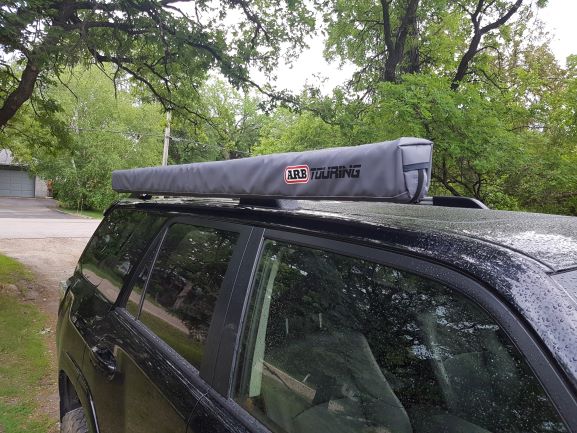

Mounted to stock rails using supplied equipment from the awning manufacturer. Not super clean but not bad, and took some finagling (bolts barely were long enough) but was able to synch it good n tight.
I am pleased with the unit at first operation. Seems good quality and able to meet my needs. I’ll test this weekend.
