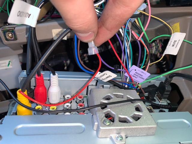

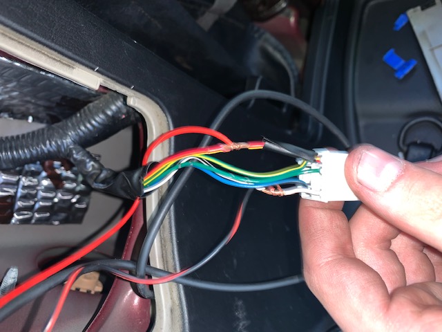

This is what I’m working with here and all the connections for the camera

Like someone else said, if the screen is going black when you put it in reverse, it's obviously getting a signal to the HU. I would think that means either your camera is bad, your ground is bad or the cable from the camera to the HU is bad. That's just based off of what I remember about mine when I hooked it up.

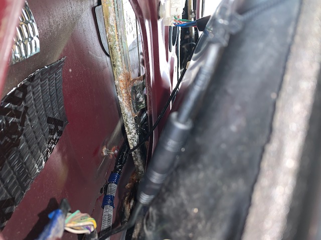

So probably not your issue. Mine worked . . . until I put the back window down and I severed the wires from the camera in the liftgate - had to learn to make sure to secure the wires out of the way of the rear window glass

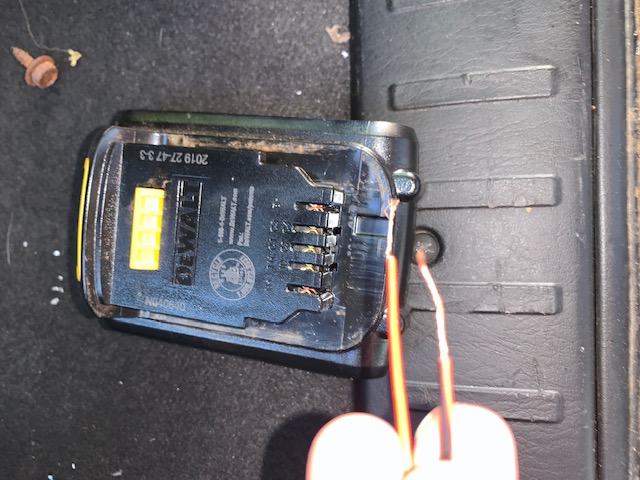

Took the whole thing out and the wires are in tact. Would this be the worst idea to attach these wires to this Dewalt battery just to see if it works?
Any 12v battery will work.
If you have ruled out the camera polarity issue.
Only other probable cause may be a shorted cable.
Try a new AV cable while powering the camera from another source, ..maybe running a test cable directly from the car battery.
