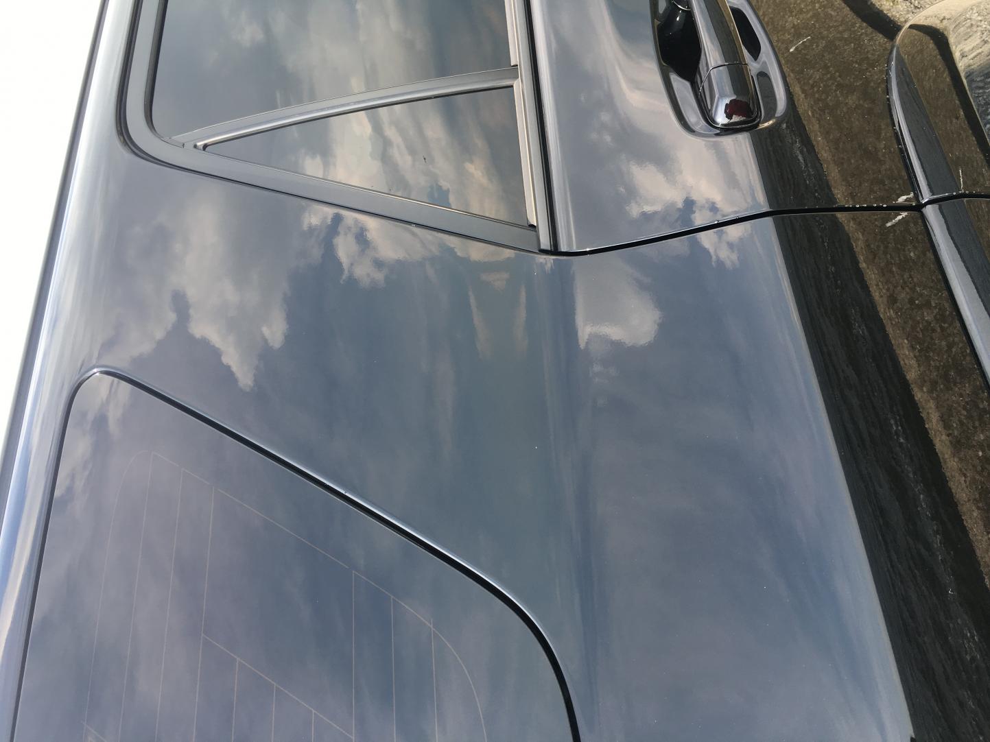

Thanks, I used this lube we have at work called zep 45, it's the same as WD40. Used a shop towel and it took a bit of effort, but the glue is gone.. then came another problem.. swirls.. thanks Sauer for the polish tip.. I hit it with some polish and damn.. I think it's still gonna need a few more hits but it looks great..
