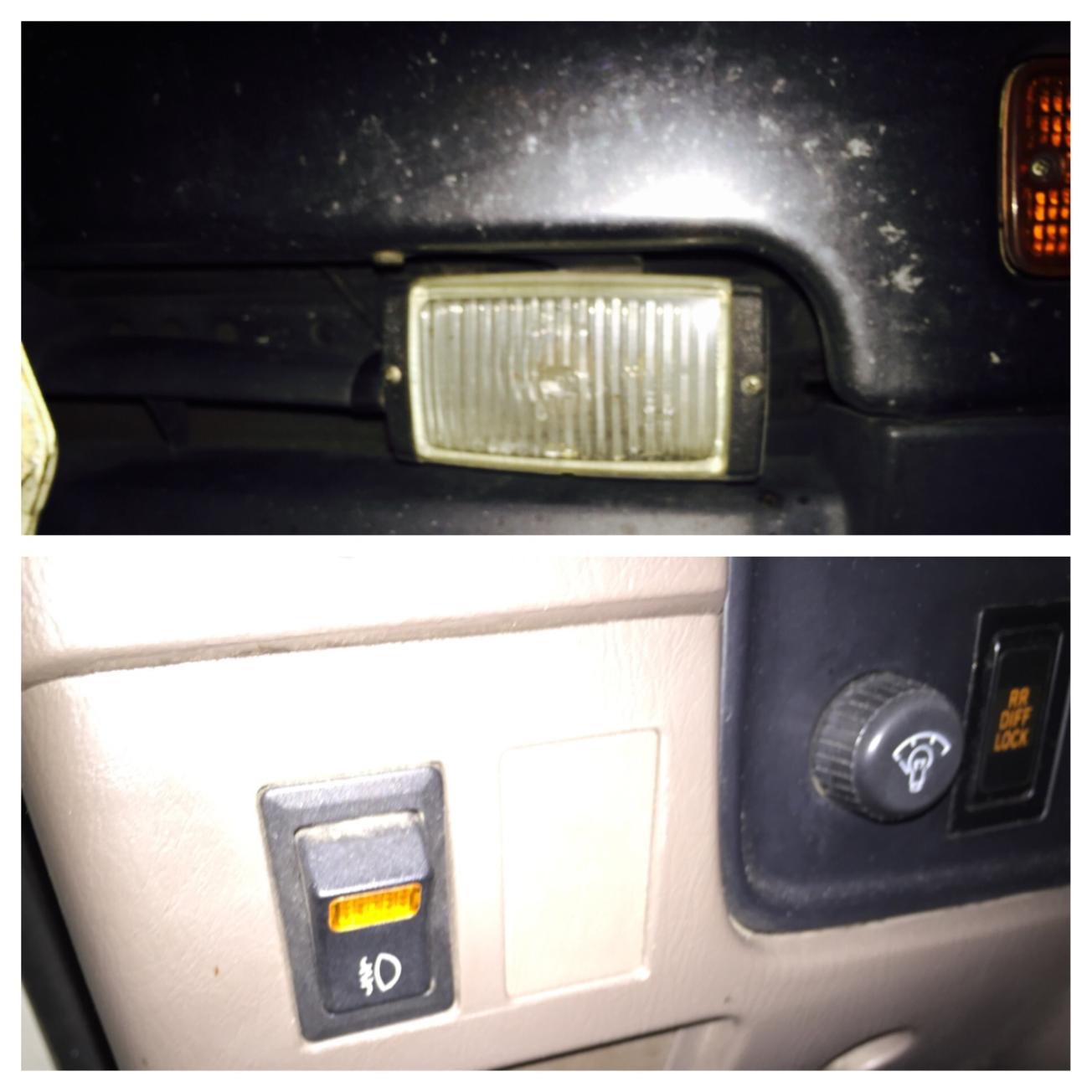

My factory foglights have never worked since I aquired the truck a few months ago and fixing it has been on my to-do list... albeit the bottom of the list. So I was a bit surprised today when I was stopped at a traffic light behind a pickup with a painted tailgate that was shiny enough to clearly show my one fog light burning brightly... I totally WTF'ed when I realized that I actually had a working fog light AND that the factory foglight switch was in the off position! I quickly threw the switch and it lit up Amber — and of course my one foglight promptly went out.
No amount of messing with the switch made the foglight turn back on.
So while I hadn't planned to mess with the foglights until other things on my to-do list were checked off, I'm wondering if perhaps there is a simple explanation for the light turning on when the switch is off, and then turning off when the switch is on.
I'm now assuming my other light is simply burnt out since it wasn't on.
Are you positive they're factory?
Sounds like maybe someone added them and did a horrible wiring job.
Just a guess.
I'm not positive but they do look factory-ish to me as does the lighted switch. The switch lights up regardless if the foglights actually turn on too.
(Sorry for the crappy pics, my phone doesn't like taking pics in the dark)

Hmm Before u go digging I would pop that switch out swap the wires in the connector reassemble and u may be in business once u replace a bulb maybe worth a shot.
I'm 90 percent sure that those aren't stock. Probably botched/corroded wiring...I'd maybe start at the light and follow the wiring back, see where it goes and what condition it's in
Those fog light were dealer add on for 97-98 year models. Some dealers added them on during the PDI process and believe the manufacturer on some depending on locations was sylvania. Toyota supplied them in there after market parts options
I'd pop the switch and swap the wires around to rule that out.
I'm not convinced they're factory. May be, but they still look a bit unusual. Maybe it's just me.
Also, they could possibly be a OEM product, but were added by someone later on down the road.
